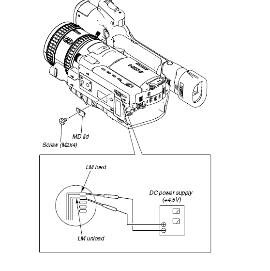

This is taken from the official Sony FX1 repair manual.
I expect the same applies to the Z1.
I accept no responsability if you try it.
TO TAKE OUT A CASSETTE WHEN NOT EJECT (FORCE EJECT)
1 Remove the power supply (Battery and AC power adaptor).
2 Open the cassette lid.
3 Remove the MD lid.
4 Supply +4.5V between the LM UNLOAD terminal and the LM LOAD terminal from the DC power supply and unload the cassete.
Hope it works.

In theory the 4.5V could be supplied by 3 x AA batteries or whatever in series, but those terminals are a long way in and super fiddly to get at. Looks like a job for a specialist to me.

Tried as hard as I could with 3 x AA batteries in a battery holder and some tiny solid-core wire with a few mm of the insulation stripped off. Didn't work. No response or motor noise or anything from the camera.
