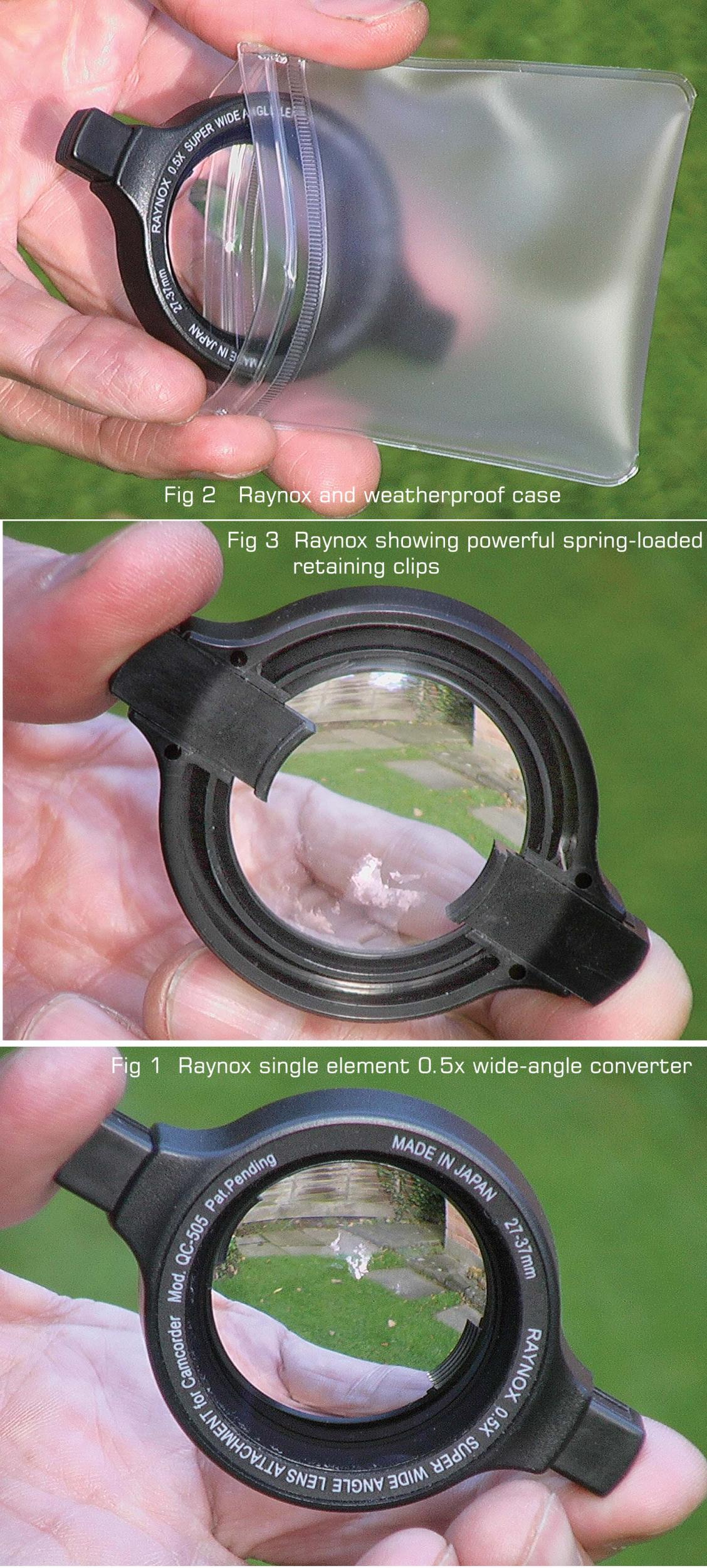

I have indeed had experience of the Red-Eye wide-angle adapters and tested the 58 mm 0.7x and 0.5x for a magazine. That was back in the VX2000 days though, so they may well have improved.
Both are injection moulded plastic single elements, beautifully multi-coated and weighing very little. They claimed to be aspherical elements and indeed appeared to be, but even so, they gave far too much barrel distortion for my liking. They have an excellent protective soft case.
On the VX2k I could partially zoom-through - instead of a 12x zoom I had a 7x zoom. Still very useful.
Raynox do some 'clip-on' single elements in the Red-Eye mould (HA!), and these are very much cheaper and work well. Barrel distort though.
