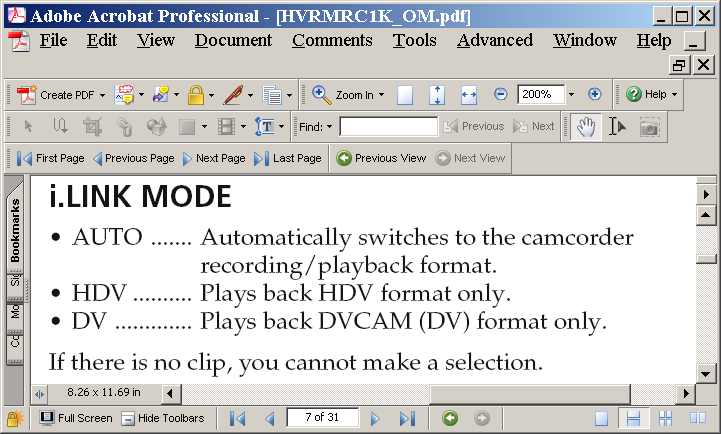

Those are playback options only, not record. We've been down this road before. Your tech is nuts. Page 7 of the manual makes this clear....it's for playback. This is why you can't select anything if there's no clip on the card, because there's nothing to play back.

Page 8 is referring to DV recording and as I said that's irrelevant if you are recording HDV. Page 7 is the only place than mentions Auto/HDV/DV, and that's for i.Link mode, which clearly states it is for playback.
You keep mixing up your questions and maybe that is why the Sony tech is confused. DV File type is about DV, which isn't related to either Rec Mode or i.Link Mode.
I'll certainly admit the manuals aren't great, and many times Sony Tech Support isn't wonderful, either.

Update, sony tech just called and windows 7 is labeling it avchd, it is coming up a .m2t file in Premiere. He also said that your "I Link mode is recording only.... You cannot change the playback of the mrc1 ("playback" means what the card records). So all of the problems are solved. If you switch the MRC1 "I Link" to DV it will only RECORD in SD not HD, Switch the "I Link" to HD and it records in HD only, so page 7 is referring to record not playback.... Sorry! Try it yourself! Mine is set on auto so that if I decided to record in sd in my camera i do not have to change anything in the mrc1. The manual is soooooo confusing!!!
