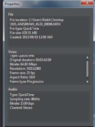

Old December 19th, 2014, 07:32 PM   #4
Join Date: Sep 2010
Location: Valentine NSW, Australia
Posts: 91
Re: FX1000, Grainy footage into Ninja Star????
Here's a screenshot of the properties from cyberlink PowerDirector.
Still playing with ALL settings in different light conditions...
Have posted on the Atomos site, might get some ideas from there...

Old December 21st, 2014, 07:02 PM   #5
Location: Woodinville, WA USA
Posts: 3,467
This is a little strange as I think the FX is stunning in low light, and if your pic on tape is good then it isn't malfunctioning. There aren't any settings that could affect the HDMI out so I'm at a loss. If anything, the pic from HDMI should be better then what's on the tape.
Best way to check would be to go from live FX straight to a HUGE HDTV monitor via HDMI while recording, then play back the tape and see what you get. If they look the same, then it's the Ninja.
