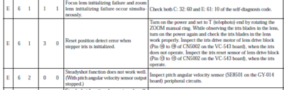

Found the error on the service manual for the camera which lists all error code
