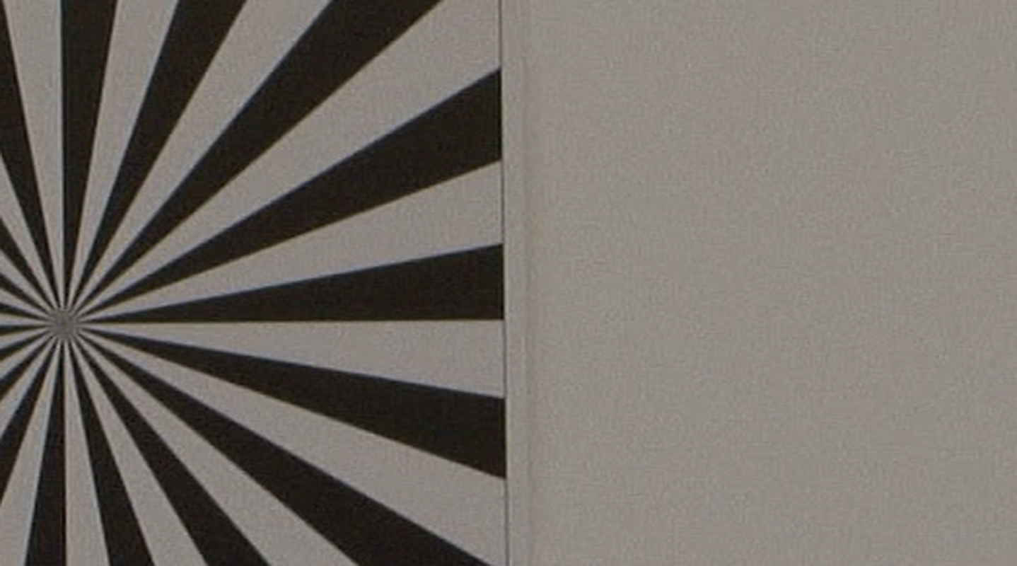

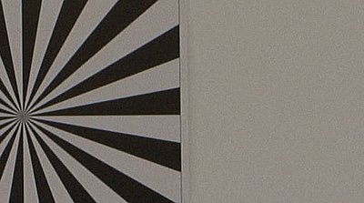

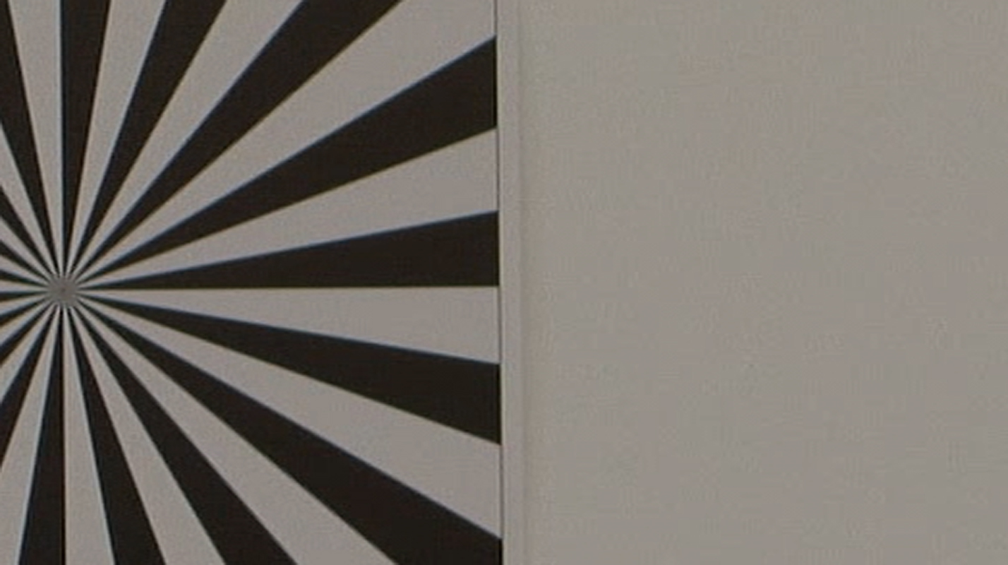

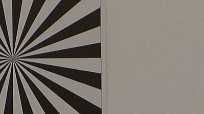

yes - all fully manual.
I've attached 2 enlarged images of the noise for comparison, the first at 0dB F4.4, the second at -6dB F2.8. The chart is on a plain white wall.

That certainly does seem like a lot of noise. I have not seen this with my camera, just the other night when the lights were really low.

Those images are dead on. That is the noise I see at 0db. Even at -6 it is still way too high in my opinion.
