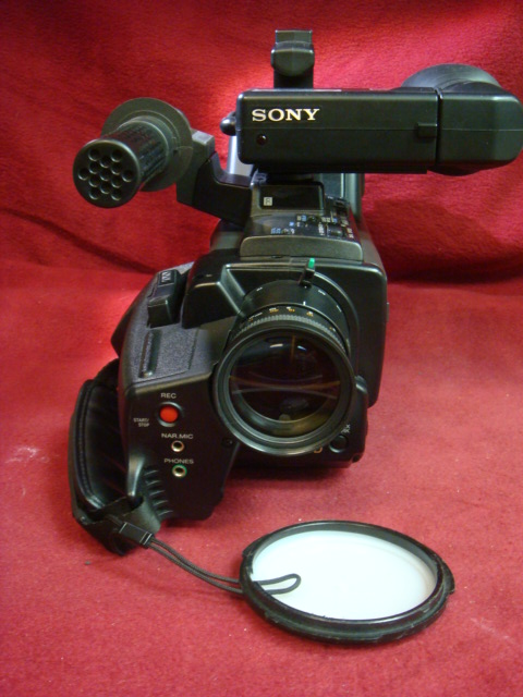

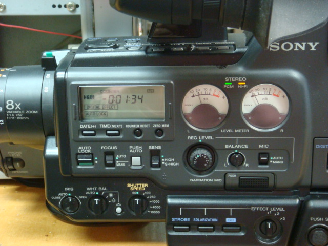

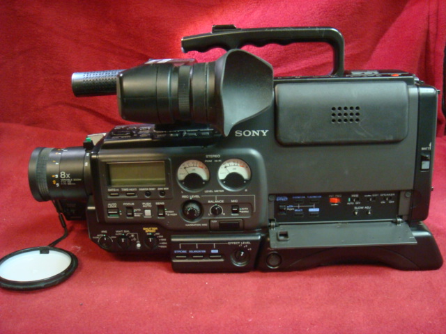

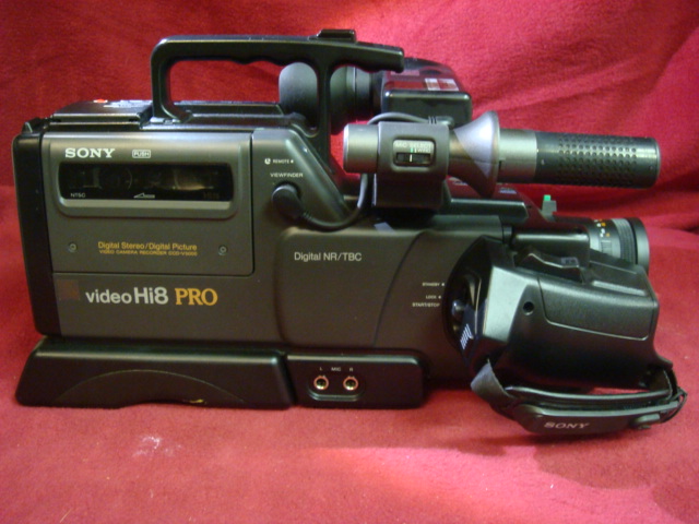

Originally Posted by John Knight View Post
About 7 years ago, my old Hi8 V5000 Sony video camera died
Other than the horrible chroma bleed -- I think the V5000 is the best $2,500 camcorder ever made. Why they can't put modern electronics in this kind of package is beyond me.
It had a 2/3" CCD.
Imagine an XMOR 2/3" CMOS chip or a CCD from a CineAlta!
