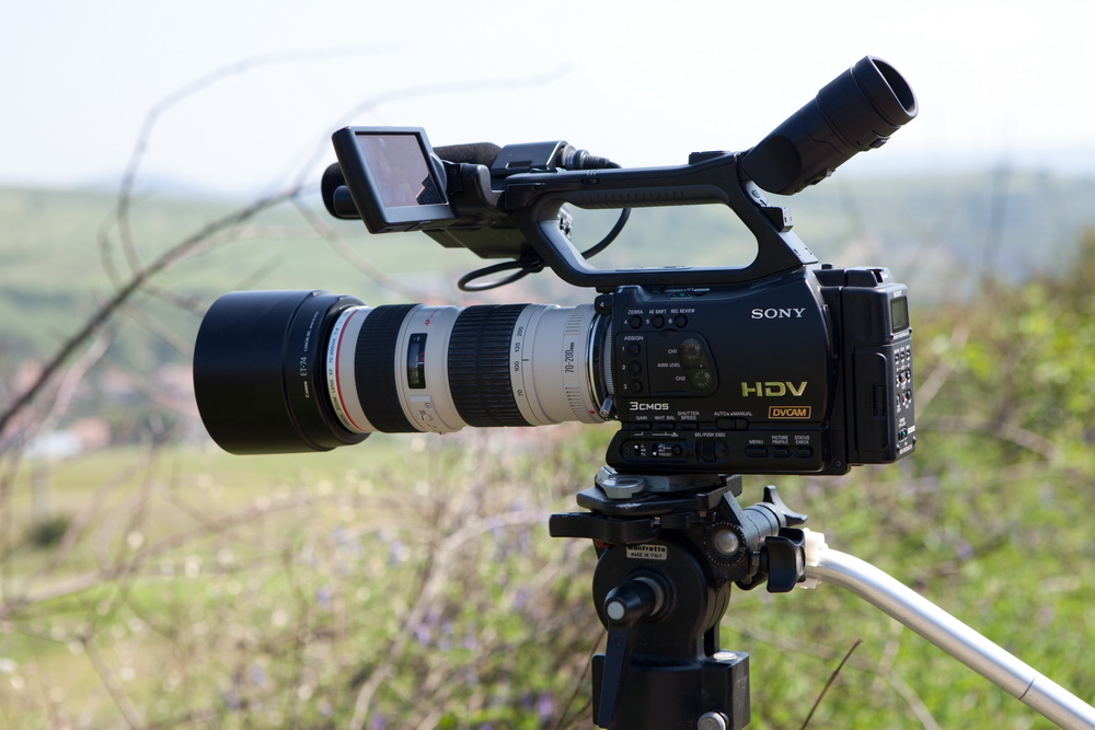

Canon ef Z7 adapter
I made an adapter but it is not quite finished. I have some shots with Canon 70-200 : YouTube - moon y2

picture of a Z7 with a Canon 70-200
the adapter must be redesigned it is not strong enough.
