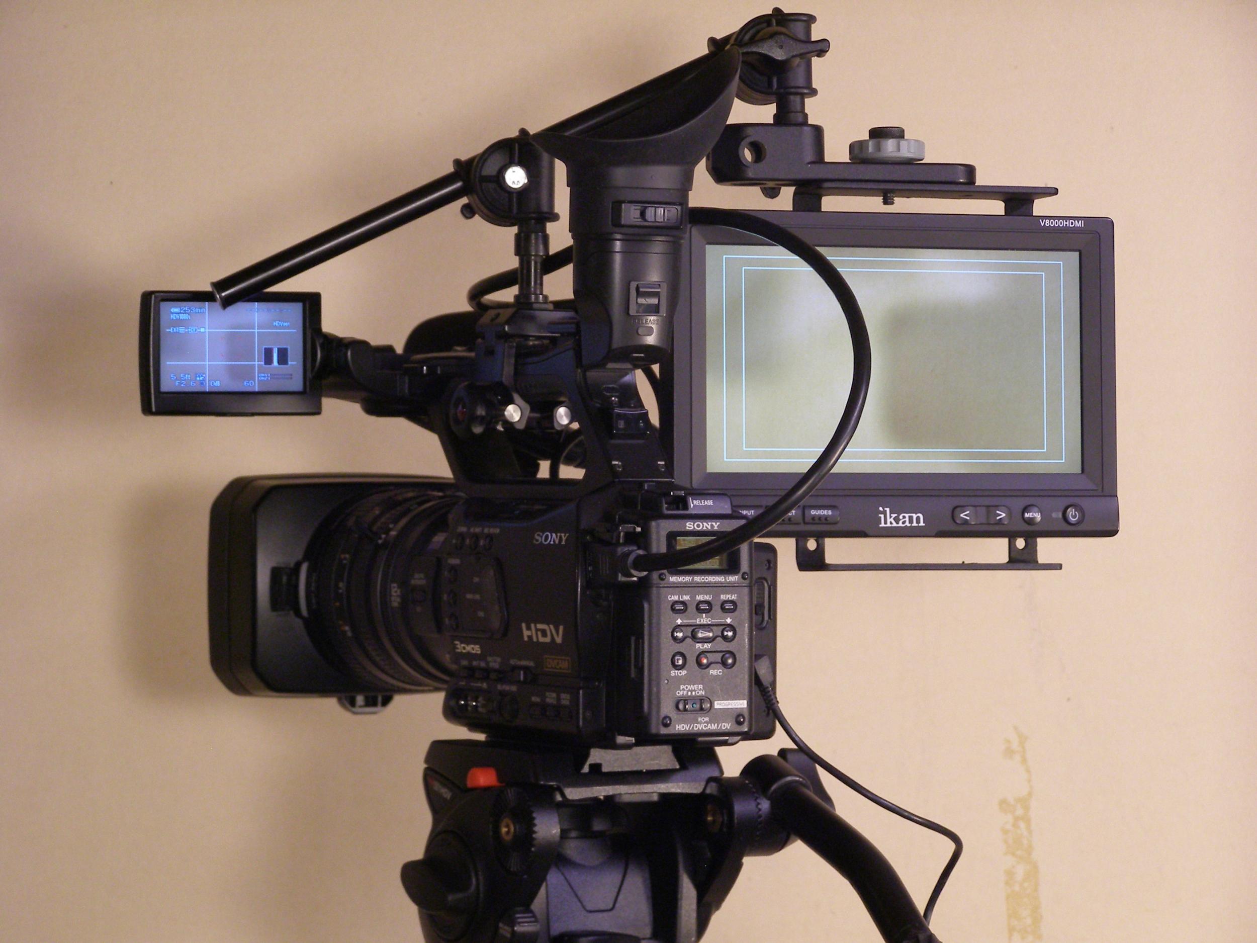

I use an IKAN V8000HDMI 8" monitor. Along with that I use an IKAN monitor arm. I plug into the HDMI port on the camera. I bought a small padded bag, designed I guess for a netbook. It is well-padded, easy to carry and not big at all.
The IKAN monitor allows very precise focusing and is much easier to watch during a long performance. I use the camera monitor to display settings.

Hi William, Thanks for posting your picture. I recently saw a Datavideo TLM-700HD at a show here in Glasgow. I had thought ages ago about buying the Marshall V-LCD70XP-HDMI.
To me in the end I could not justify the cost at the time (did not see the full benefit)
It was only when I started shooting more in Low Light and I see the benefits now, this has also been confirmed by the responses so far to my question. I will be looking at this more seriously after Santa has been.
