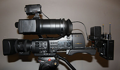

Hi Guys
I have been playing today and working but I'll shoot a Realty job with the camera tomorrow and a wedding on Saturday.

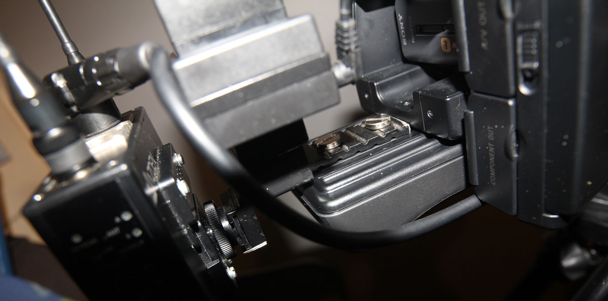

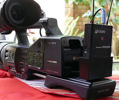

The receiver mount was stupidly easy..All my Azdens come with a plastic box and a cold shoe mount so I took off the cold shoe bit and drilled the hole out to 1/4" and it screws right into the shoulder pad..easy as that and no issues..(pic is below)

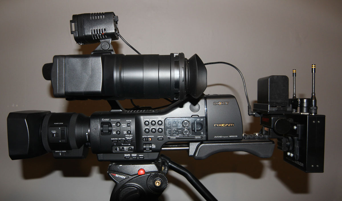

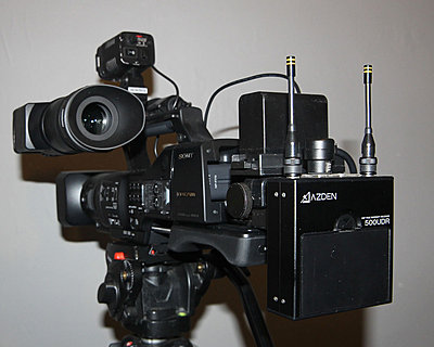

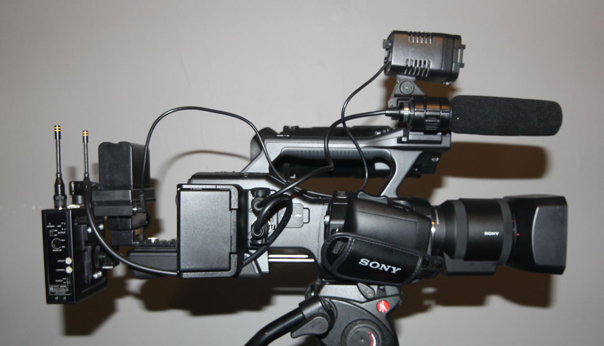

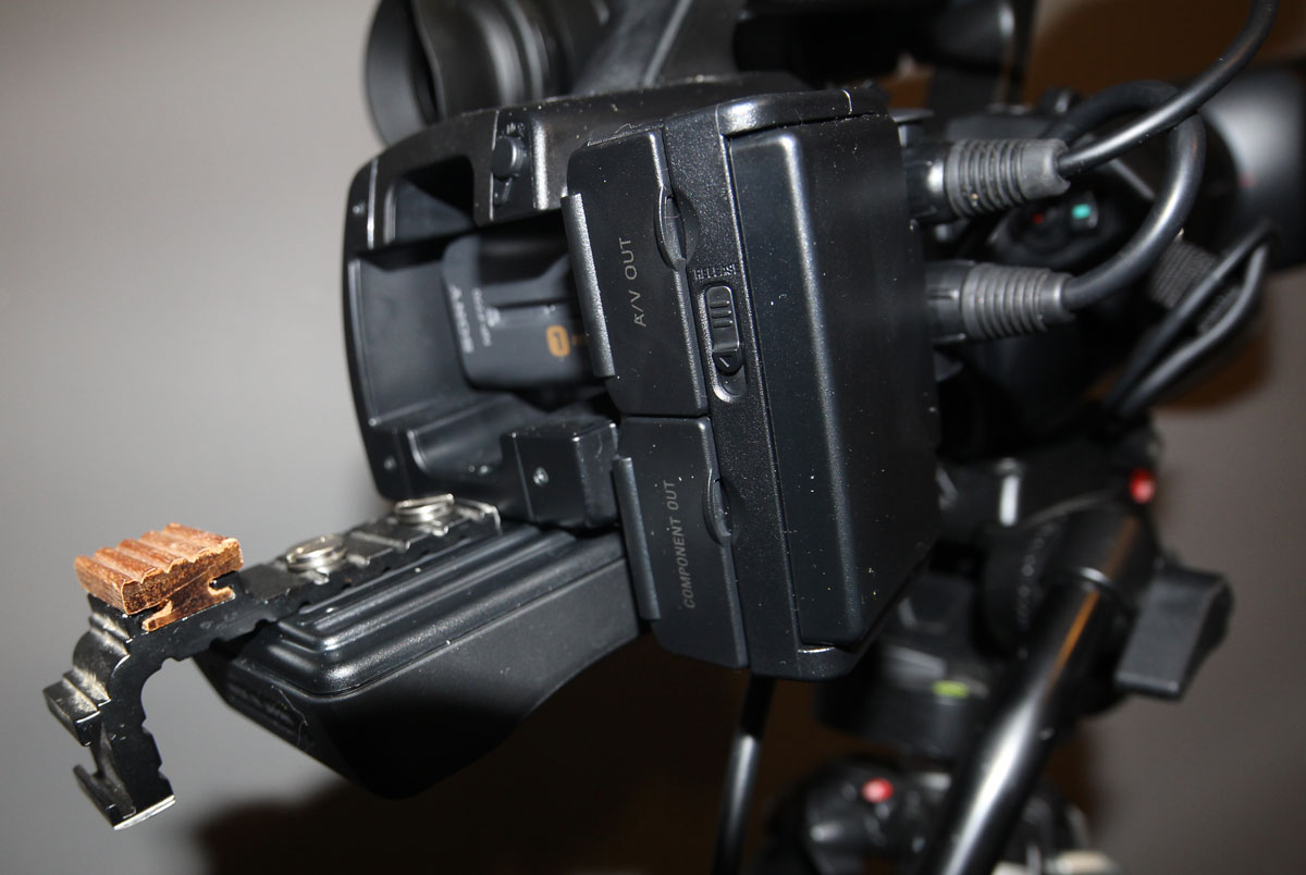

Back on topic: Here some pictures how I managed to attach my azden and swit battery, I just used a old metal hotshoe adapter that was collecting dust, in one hotshoe I custommade and inserted a wooden small block that has the same size as the clamp from the swit batteryholder. Not sure how much wheight the extended shoulderpad can take but as long as it's on your shoulder it's no issue. It doesn't balance the camera on your shoulder but I was surprised how light (taken te size and accesoires into consideration) this set up is when shoulder mounted.

That looks really awesome!! I tried using the dual channel receivers and found the ones here just had no range ...I think due to size, the receivers on the new 300 series are non diversity and are hopeless..yours look like the 200 series and I think work well. I already had two 100ULT systems so I got another after selling the 300 and just mount two receivers on the back of my "A" cam. What is the Swit battery used for ? The video light?? If it is then that's clever..I might just run a cable from the light (it has a DC in) and use the battery at the back to get better balance. The manual says the pad can take 1kg

Noa...thanks ..brilliant idea and much nicer weight distribution..I have several old chargers so I rip out the electronics and use them as a "battery carrier" on the back so the cam is less front heavy!!
