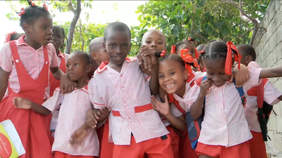

I use Yellow. High. I used red until I came upon the scene in the attached. I haven't come upon a scene where Yellow didn't let me get good focus.

I've been using red, high, but based on the photo above I may try the yellow. What I've found though, at certain focal lengths, peaking does not display as well. So perhaps the most accurate adjustment would be with the Expanded Focus.
