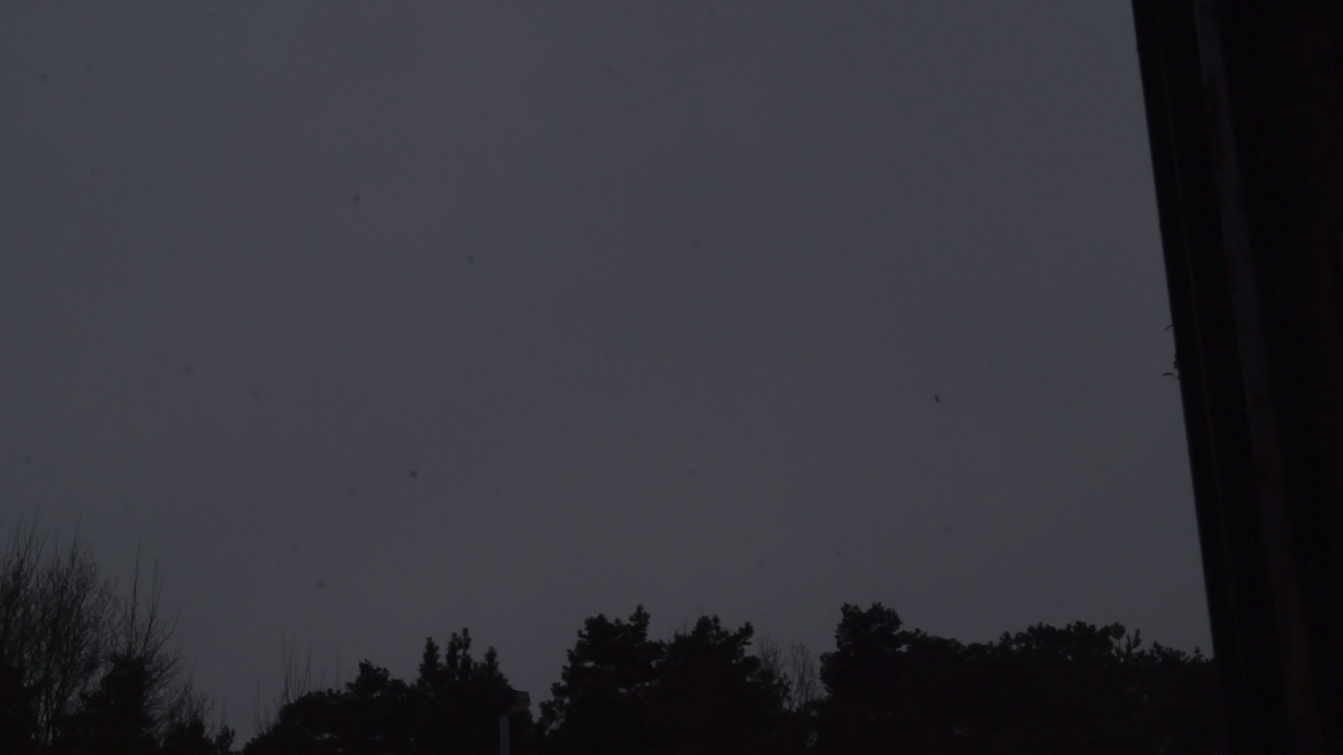

I was out shooting again today, just some random stuff nearby from some windmills, and when I just saw the footage at home the dirt spot I had in my casino video appeared again on the same place in the bright parts of the sky. Only this time I had the stocklens on and at the casino shoot I had my primes on. I checked the lens and couldn't see anything, then I checked the sensor and at first I didn't see anything either but from certain angles then it looked like there was a very tiny spot visible but you could hardly see it. I used a small pump with a brush that my wife has to clean her lenses and blew some air at the sensor and did another shot of the sky and rechecked and the spot was gone.
Never had this issue with my dslr but that sensor is much better protected, it seems you need to be real carefull when changing lenses and double check with the loupe (I didn't have the loupe with me again as I thought the "spot" problem was solved.)

ugh, just found out the sensor if full of spots, I shot a grey sky again and underexposed as much as possible and then several spots started to appear like ufo's.
My wife also has a Arctic Butterfly sensor brush but she not home right now and I couldn't find the brush, will clean this evening and see what that gives.

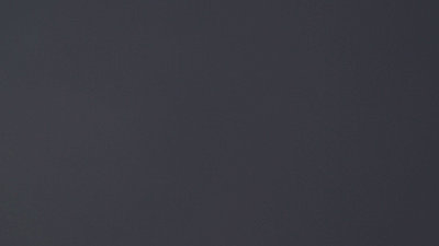

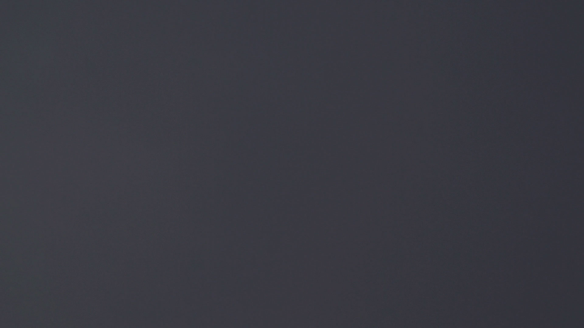

Thx for the tips! Much appreciated. The Arctic Butterfly sensor brush finally removed all present dust or at least I don't notice any spots anymore in normal exposure when viewing a grey sky, see photo below of a before and after.
The dust got on the sensor at the casino I filmed when I changed lenses, the sensor is also out in the open with no protection or sensor cleaning tech at all, so I need to check before each important shoot.
