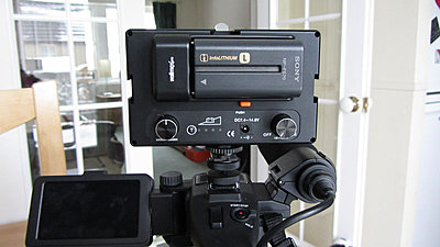

I use this Wallimex Pro LED light along with a Sony F570 Battery - lasts for hours plus you can dial-in colour temperature - great for a little warming/cooling! and with the F570 it doesn't add too much weight so the balance still feels OK

Nice Pete
What you can still do is mount the battery back behind the shoulder pad like I have done and then run a cable back to the light..I see there is a DC socket on the back. Is that a PowerLED unit (with up to 10 big LED's) or is it a multiLED panel with like 150 +++ 3mm LED's ... You never showed us the front!

It's multi LEDs like my Fotodiox 312AS. The big difference between Peters and mine is I can run mine off of 2 batterys at once, although when I use it on my 700 I just use a power tap cable back to the camera battery. Sucks up the juice but eliminates the weight.
