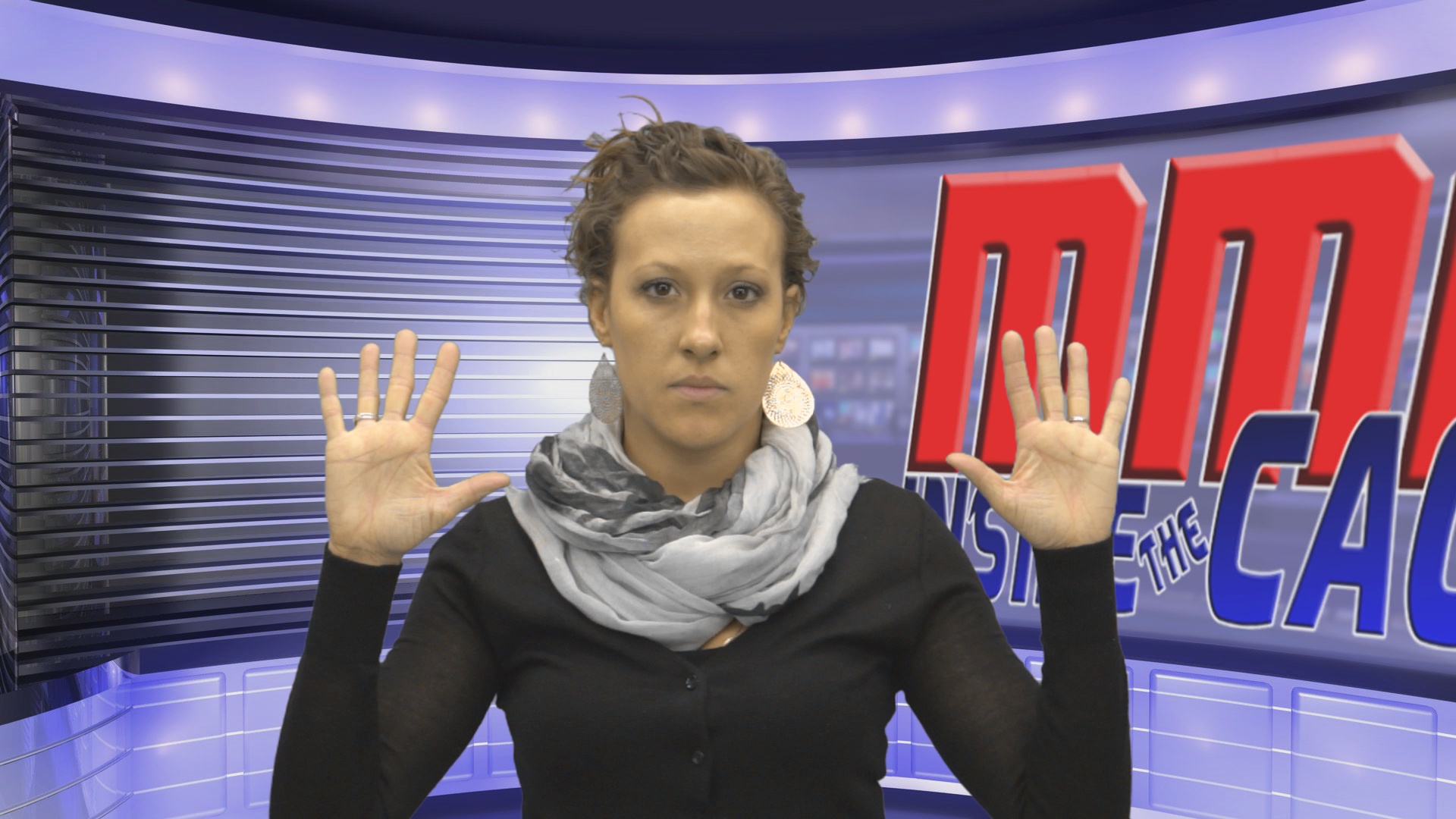

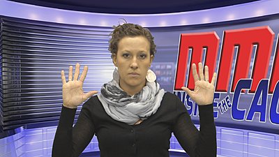

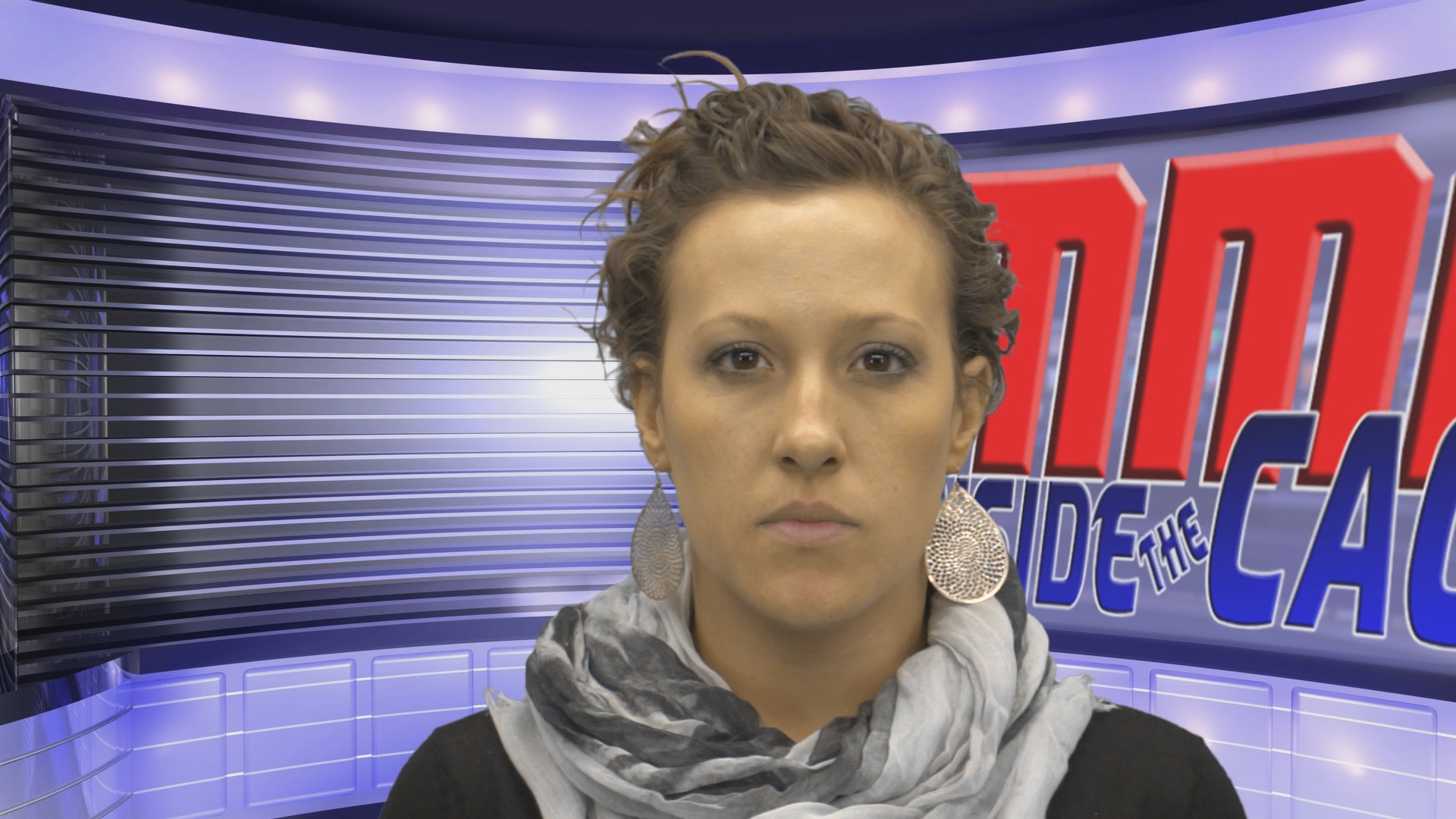

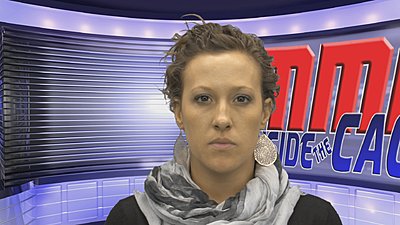

So here's a quick and dirty test... I just used the background for the TV show I make...
Attached are 2 jpg's and here's a short clip: Quick green screen test Sony NEX EA50. - YouTube
Note, her ear rings are shiny metal and DOES have tiny holes. I was amazed how that worked out!
Her hair could have been better, but it is better than HDV.
I want to get an ATMOS Ninja HDMI recorder so I can get 4:2:2 colorspace which would be dramatic improvement!
I am happy with this quick test. More backlight on her hair would have made this better. I just didn't have time to set it up right now.
