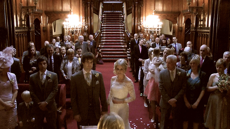

Absolutely Chris I was filming at a castle at the weekend and apart from 2 big chandeliers at the back of the hall, the only light on the people at the front (inc bride and groom) was from a couple of spotlights on the floor behind the registrar! So not only was the light not sufficient but the couple were lit from underneath! Also the walls were all very dark oak which didn't help.
I would say IMO 1 wedding ceremony in every 10 has lighting conditions not conducive for good video - The EA50 handles it better than my old Z1 but I'd still like to improve the quality for my customers (or is it for me as my couples always love their videos)

I take it you are using the stocklens? In that case you can best use 1/25th shutter to squeeze some extra low light performance out of the camera, ceremonies don't have much movement in them so a slower shutter won't cause any problems.
