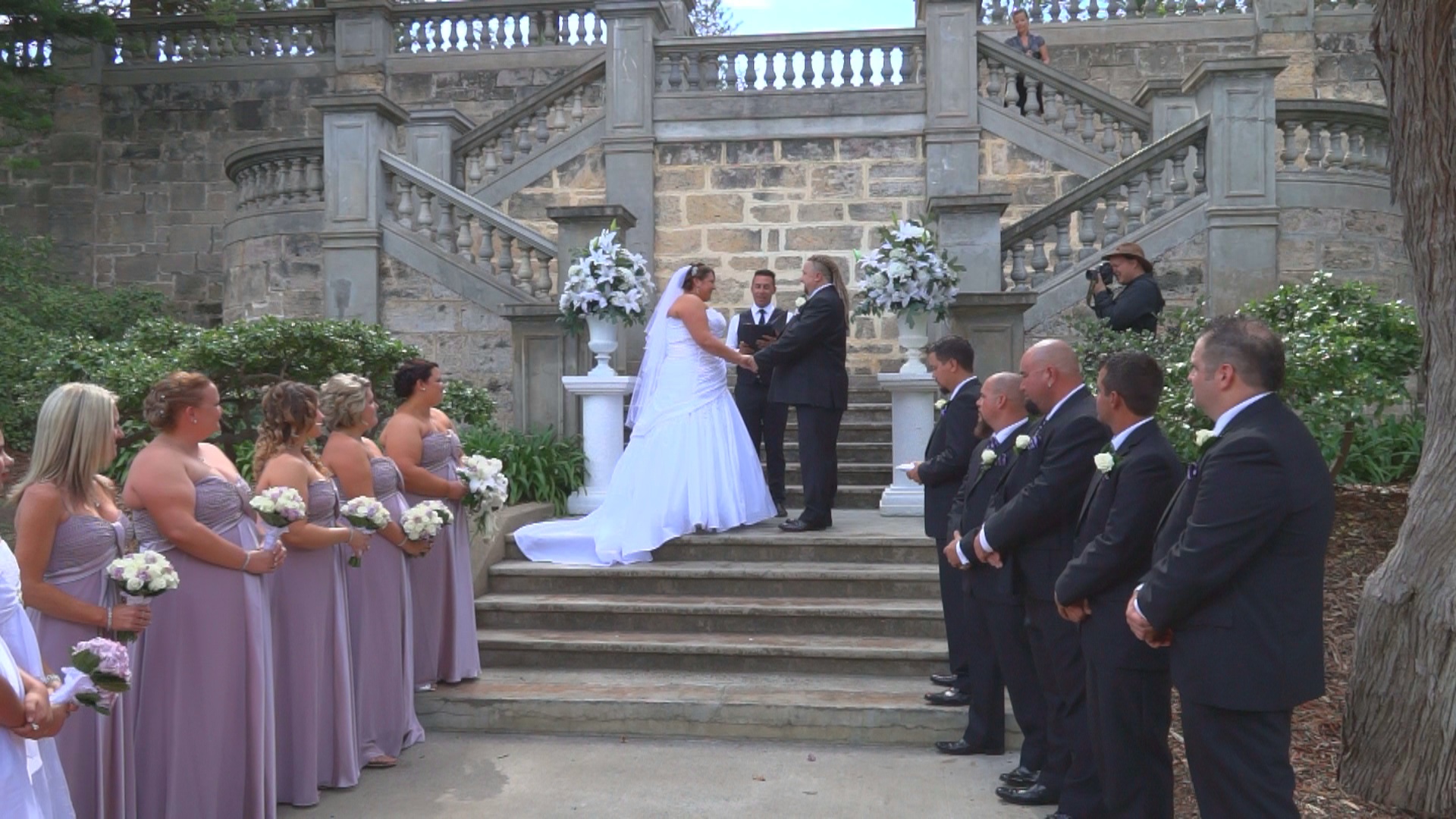

Here are two screenshots from the wedding yesterday. I chose a wide shot just to show how the colour saturation level is low and very noticeable on green bushes etc etc. On the second grab, all I did in Sony Vegas 10 was add the Colour Corrector Plugin and ONLY raised saturation from the default (no adjustment of 1.00) up to 1.500 and it lifts everything nicely without giving abnormal skin tones. Indoor shots on PP3 are great as they are...it's only a bit unsaturated on bright sunny days outdoors.
Of course if anyone feels differently, please voice your opinions !!
Chris

you can use AAV ColorLab plugin for Vegas (its free) so you can adjust saturation independently (R-G-B-C-M-Y) for better results. (can increase more the green and reduce reds for example)

I have the plugin already .... looking at the saturation adjust what do you think?? On PP3 I find that the overall saturation is low on all colours that's why I simply push saturation a tiny bit to lift it overall. Based on the overall scene in real life, the colours are reasonably accurate and simply a bit low on all channels to me rather than needing individual adjustment the levels thruout needed to be lifted. Using PP3 the greens are not "wrong" they are only low so areas like grass and trees look a little washed out and if you lift all channels equally they seem to come up to true colours. You can see the bridemaid's dresses are also a bit washed out but also come out to true levels with saturation lifted. The one thing at weddings is the BM's dresses have to be "correct" ...you can have out of wack scenery but if the bridemaid's dresses were pink then the bride wants them to be pink and nothing else!!
This is only with outdoor shots ...Indoors at venues the balance looks pretty good as it is.

i can't judge the saturation for now cause im without my editing system (lightning killed pc/tv). but looks like 1.4~1.5 saturation looks about right.
I'm very "OCD" about color. i did a "color profile" (Using AAV ColorLab) with my cameras utilizing colorchecker and photos taken with DSLR in the same instance. i do a lot of selective adjustments (like remove the blue tint on the bride dress)
some colors have hue shift, low saturation, low brightness... more the "low end" the camera gets, more "imprecise" they become :(
my AE50 will arrive in a few weeks, after that, i will need a week just for testing and adjusting ;)
you are right about dresses colors, skin tones and dresses are the main target. here (brazil) almost all weddings are at night, so people use very colorful night dresses, strong, saturated metallic colors... so a little shift in white balance alone can make a metallic blue/cyan become a greenish one. :P
