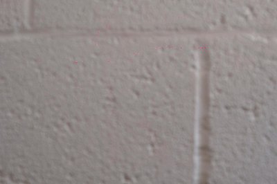

Hello to all,
Has anyone else heard of this problem and have any idea what might be causing it. I have a number of pink dots on my sensor, as if my little girl has put pink felt tip pen on it. She obviously hasn't but that is what it looks like. I have checked with different lenses and the problem is still there. If you point the camera at a white wall, you see the pink dots quite clearly. Help! Does anyone know what I can do to rectify this problem or clean the sensor?

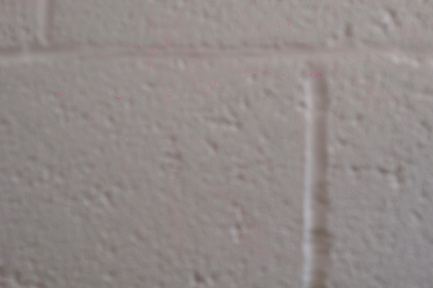

Old July 22nd, 2013, 08:33 AM   #4
Join Date: Mar 2013
Location: Leicester
Posts: 119
Re: Pink dots on the sensor
Here are the dots for you all to see.

Old July 22nd, 2013, 08:48 AM   #5
Location: Belgium
Posts: 9,512
That's no dirt on the sensor, I have managed to keep my sensor clean untill now by using that arctic butterfly thing before every shoot but what I see here looks more like a sensor problem, the camera needs to be send in I think. Has the sensor been exposed to direct sunlight for a longer period? Or maybe some laser lights? Just guessing.

Old July 22nd, 2013, 11:01 AM   #11
Location: Belgium
Posts: 9,512
There is quite a few examples on vimeo and-/or youtube showing exactly the opposite what this guy is claiming with clear damage to the sensor, I"m sure it must have to do with the intensity of the beam, I also read reports from people with damaged eye sight after been exposed to a strong laserlight.
