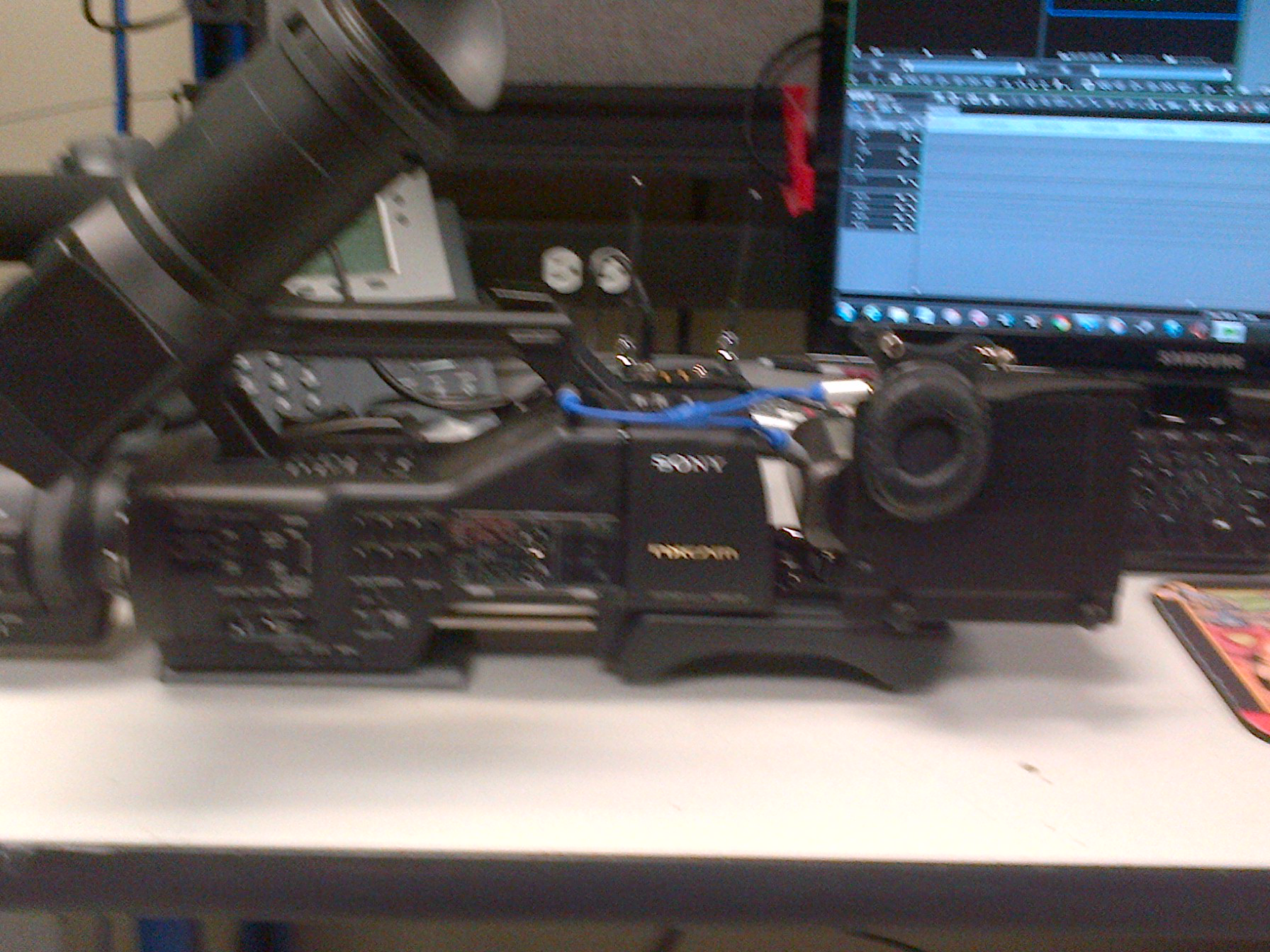

by the way here is my audio speaker solution! Works great!Suck it Sony:)

Really? No offence Randy. Do you have something against headphones? You may be able to hear audio through that but what about hearing the quality of the audio?

Even when I play back clips the audio coming from the speaker (or a headphone piece) is still not the best quality and that's mainly due to ambient noise that your open ear gets in! I guess it might work ok if you blocked off your left ear totally and snugged your right ear against the earpiece? I still prefer headphones as I have XLR 1 coming in on one side and XLR 2 coming in on the other side so I can monitor each wireless mic set.
Steve? I think you are a lefty aren't you??? so that wouldn't work at all for left handed people.
What does work very neatly is to have a Bluetooth transmitter plugged into the camera and a Bluetooth headset on your head ...that gives you total freedom if you like to monitor audio all the time. You can find these easily on eBay!

Well a couple things here 1. Nothing I hate more than trying to work in the field and my headphones get all tangled up. 2. The speaker is perfect for run and gun confidence to make sure the wireless is working and has no interference and is close enough to the subjects mouth in noisy rooms. 3. You noticed the Y splitter because when I can I do plug in a regular headset. Oh and Chris as you know we both kinda came up with the BLuetooth idea a year or so ago I dont use it much anymore because I was having problems most of the time it worked but I found myself doing more field troubleshooting than I wanted to do plus you remember the issues we had with the Azdens well my is working great now and the only thing I changed was I dont use the bluetooth anymore so there is reason to believe that the bluetooth was stepping on my range a bit.
