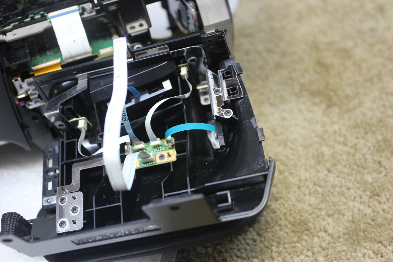

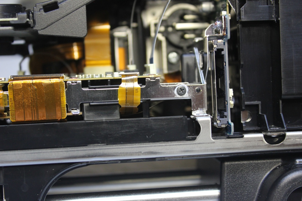

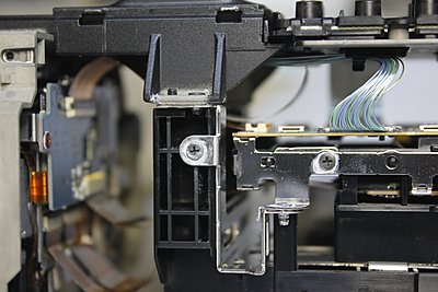

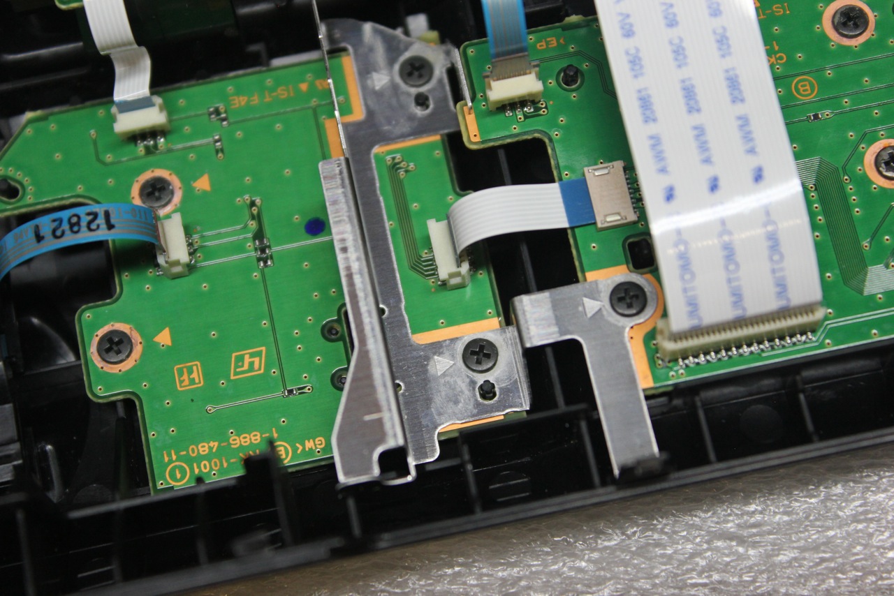

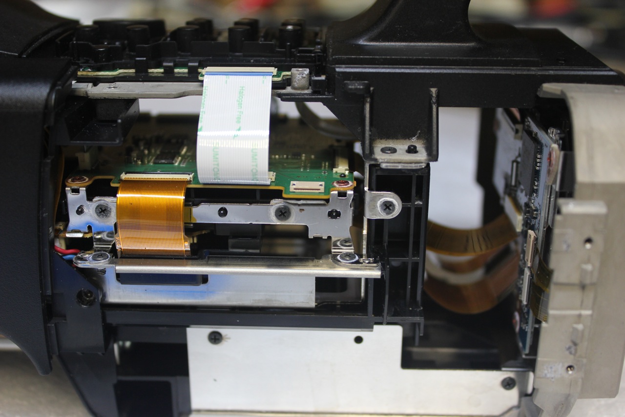

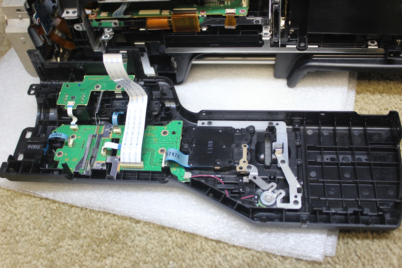

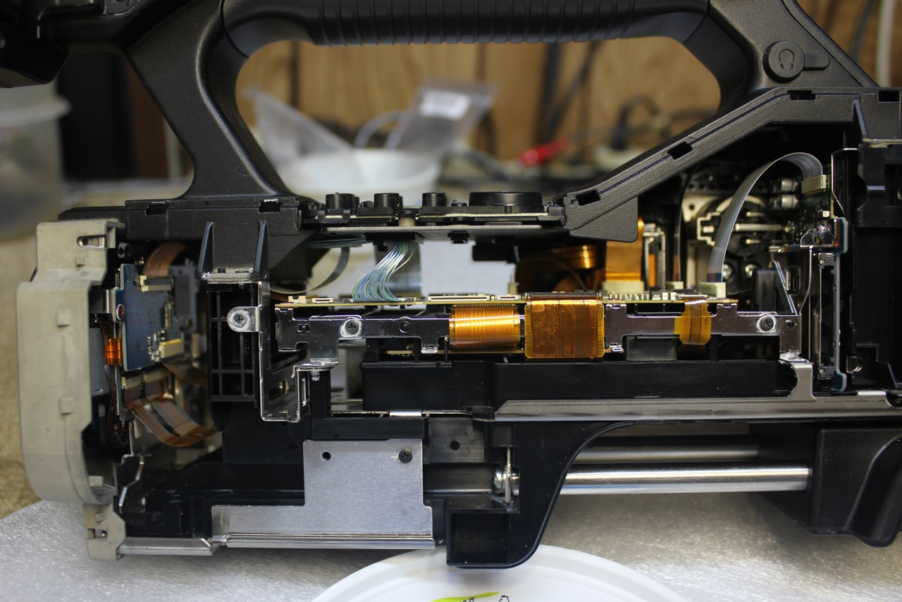

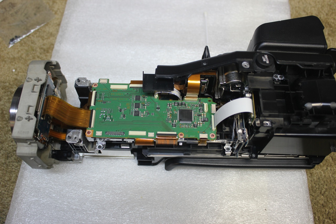

Hi Friends,
As the subject indicates, my EA50 went 7ft deep into a lake recently. I was shooting a family fishing trip in Northern Manitoba. It was underwater for about 45seconds. I won't go into the gory details, but suffice it to say, I had a very, very bad day. The lens was FULL of water. I pulled it all apart and stuck it all in a garbage bag with 2lbs of rice which was what I had at hand.
I write this now that the camera has been replaced by my homeowner insurance, but in the process of proving it was not reparable, I took it to a good friend who has been an A/V tech for decades. He opened it up and took pictures... mostly proving the corrosion.
So, the old camera body totally works for now! I am told that corrosion is the silent killer, and it could stop any time. There is no lens control at all, so I am now in the market for a manual adapter so I can stick my old Pentax K-mount lenses on it. A manual EA50 as a second camera would be very sweet.
Anyway, a major learning, beside being more careful with the camera around water, is about insurance. Any of you making money with your camera surely have the right insurance, but I was just getting into freelancing, and it became very clear in this process that I would not have been covered if I was making a single cent off the project. It will be expensive, but I am buying insurance this week to cover my commercial uses of the camera.
Finally, I've attached a whole bunch of pictures that some of you might get a kick out of.

While it's apart, take the time to go through everything with some electronic cleaner - with a soft toothbrush - if you take the time to carefully clean all the contacts and boards, you may be able to keep corrosion from taking it's eventual toll. If it's actual corrosion, a baking soda and water (preferably distilled or ionized type rather than tap) can clean that - obviously it's a tedious process to take the needed steps, but I've restored "dead" cell phones (which often take unexpected swims!) with patience and careful cleaning and rinsing of the crud that can form so quickly...
Just a few ideas, if it's still stripped to bones - it MAY live again! You don't have anything to lose at this point from the sounds of it! Good luck!

For what it's worth, the technician who looked over the wet camera says he has seen a lot of weird stuff, and is completely amazed at what still works on this unit. He keeps talking about it having been baptized. :)

Sorry about your mis-fortune but it's interesting to see the inside of an EA50 considering I own one, thank you for taking pictures and uploading them!

The Voigtlander adapter arrived today. Feels like a fine piece of gear. At $180, just to dumb adapt, it should be... so the good news is that the camera that spent almost a minute in the lake is now completely functioning!
