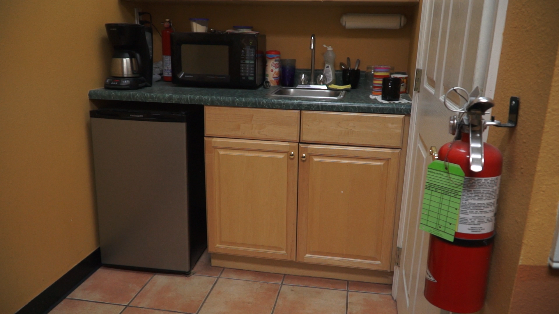

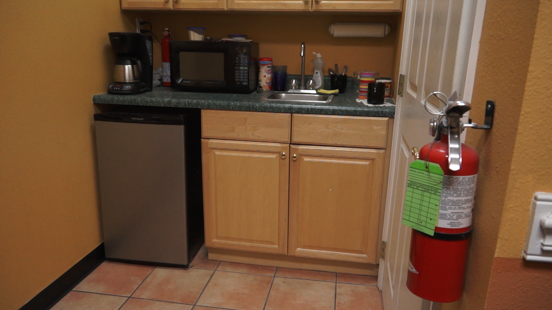

Tom:
I did a test today of both lenses at f4 and the 18-105 does appear to be slightly darker than the 18-200 . Also I'm surprised that with both lenses at full wide (18mm) there is a difference in the image. The 18-105 is not as wide. What the heck?

At full wide the 18-200 should be a bit lighter as it's 3.5 at the wide end. Or did you set it for f4 even wide?
As for the difference in field of view that is weirder...

I had them both set at f4, however since the kit lens goes to 3.5 there is some wiggle room as you adjust the aperture control from the point where the VF shows f4 till it indicates f4.5.

It's the electronic correction of distortion and vignetting that makes the picture less wide and a touch darker.
That's the cost...
I adapted a Canon EF 24-105/4,0 L IS on a speedbooster. It behaves as a 17-75/2,8 now but was a costly alternative. Know what: There's distortion on the wide end too - not correctable...
