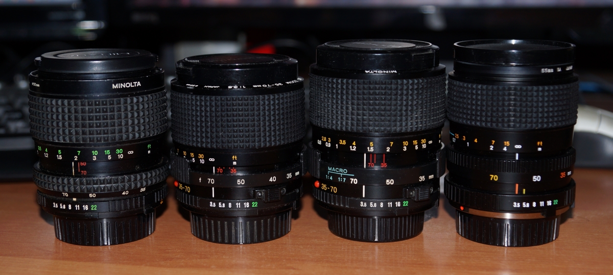

There were four variants of this lens. I have all four of them see attached JPG. If you are after one of these the third from the left the Macro version was reputed to be the the best although all of the first three are good. The first on the left is the original, with the narrow zoom ring, the second from left is the one Leica got excited about and had remodelled and marketed under their name. The same happened with v3 the macro version, my favourite, the third from the left.
Now the fourth from the left. Don't go within a mile of it! It's a piece of rubbish. This lens was a product that was born out of Minolta's financial problems not long before they became Konica-Minolta. It's a cheap plasticy ghost shadow of its forbears. It is also not constant aperture as it is f1:3.5 to f4:4.8. These were not built by Minolta. They were produced by an outside contractor during Minolta's financial troubles.
Good quality examples of v2 and v3 can be found on eBay for around $60 to $100 but be quick as they are going up. My v3 cost me US $65 a couple of years back. You won't be disappointed unless you are very hard to please.

Useful info!! I'd like a 35-70 constant F3.5 for weddings BUT they seems hard to find ... Plenty of F3.5-F4.8 so am I right in assuming those are the crappy plastic models that are the same as the 4th from the left as per your image ? Are the first 3 (v1.2 and 3) all constant F3.5??

Look maybe I am being a bit unkind. The v4 model works but it's not close to being in the same league as versions 1~3 which are all high quality good value lenses if you can score a good specimen. v1 ~ 3 are all parfocal and constant aperture so no light loss on zoom. v3 is my favourite because of the added bonus of the dual range macro.
