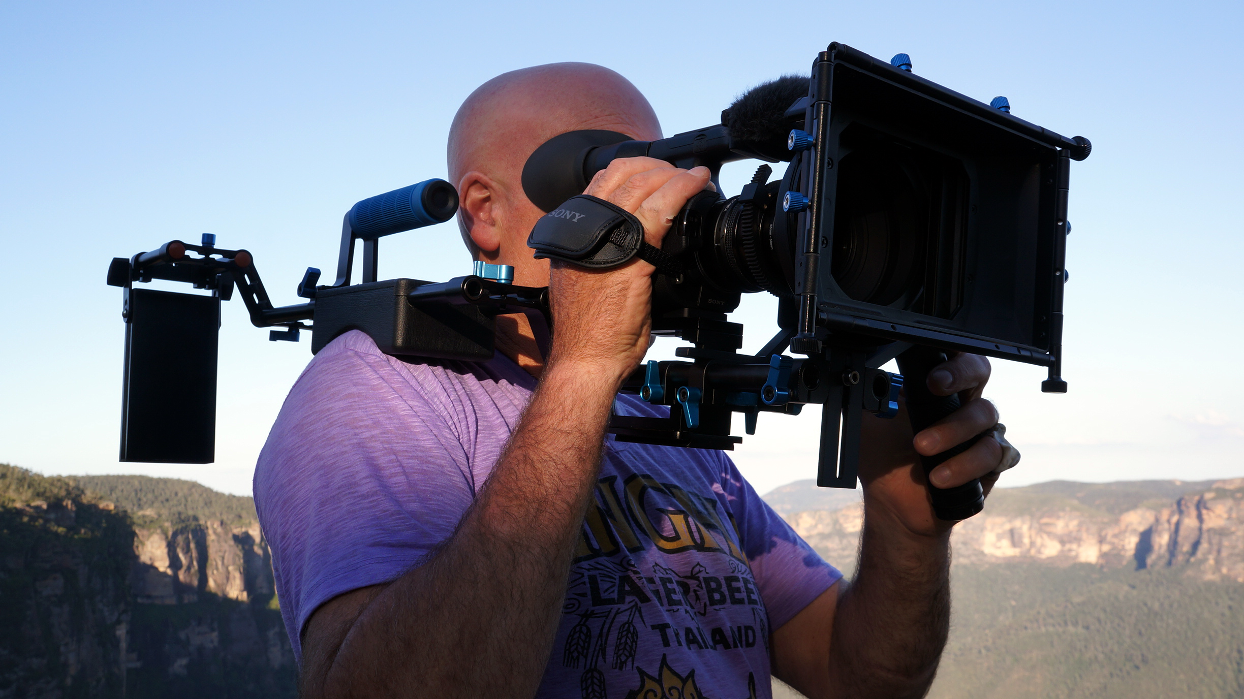

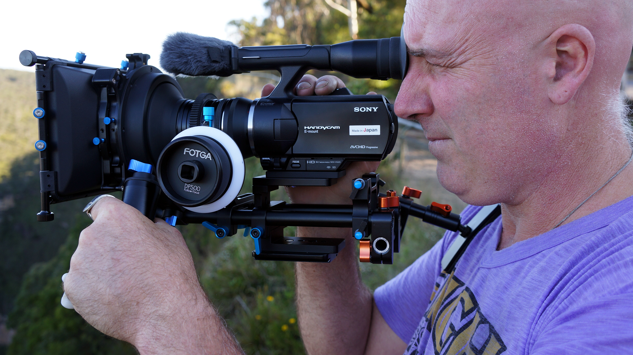

This is how I did it with the Vg20. There's over a kilo of lead shot it that black box at the back of the first shot but the rig works very well and is perfectly balanced, both N/S and E/W. As good as any ENG camera I have used. The counter weight, shoulder pad and carry handle are on separate rails so the pre assembled unit simply slides onto the same set of rails the camera and matte box are on. It takes five seconds to grab and fit to the back of standard rig shown in the second shot. Follow focus is thumb operated and all components shown are available cheaply on-line.
Anyone using a counter balance weight?-nex-vg20-counter-balanced-shoulder-rig-3.jpg   Anyone using a counter balance weight?-nex-vg20-zeiss-prime-3-point-rig-2.jpg

That's how it should be done but it becomes very impractible at a wedding because of it's size, the ea50 would require more wheight at the back because it's twice as long as a vg20.

I like the chest pad that craig posted. How about this: again with the $20 plastic fantastic cowboy studio thing: remove the little top extension , put a macro rail on the camera and attach the rail to the base of the plastic fantastic. Now you can move the camera back and forth using the rail (I bought a $12 macro rail to use on tripods and works fine). and you can move it also wwhen on the bracket! The "breathing thing" is still a problem and that's why I'm going to try the chest pad. Just an idea. We are all trying to put the thing on our shoulders.. all of us LOL one by one . so far the plastic fantastic is definitely the system that gives me the best stability (I have to breath slowly.. z'all LOL)

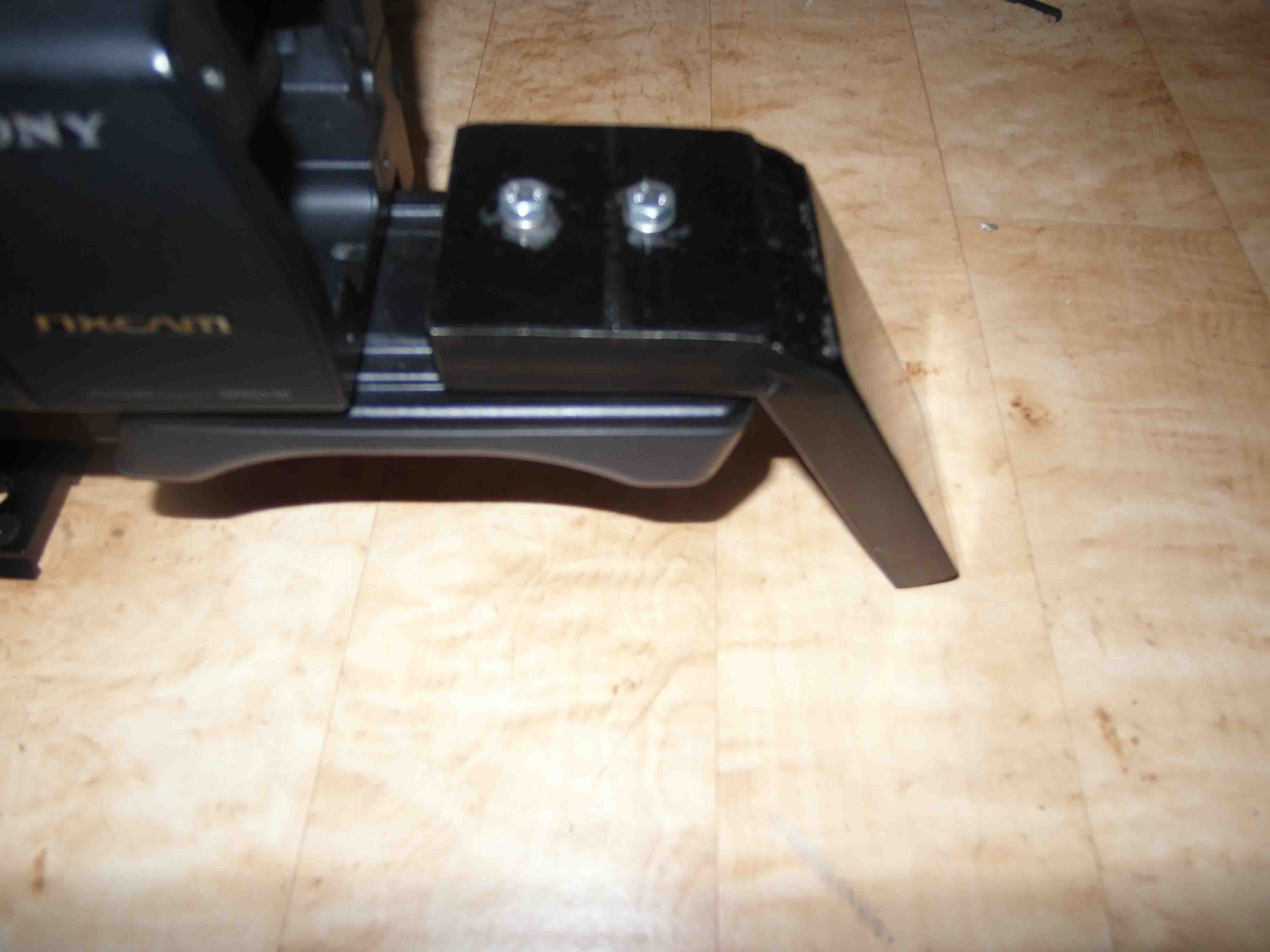

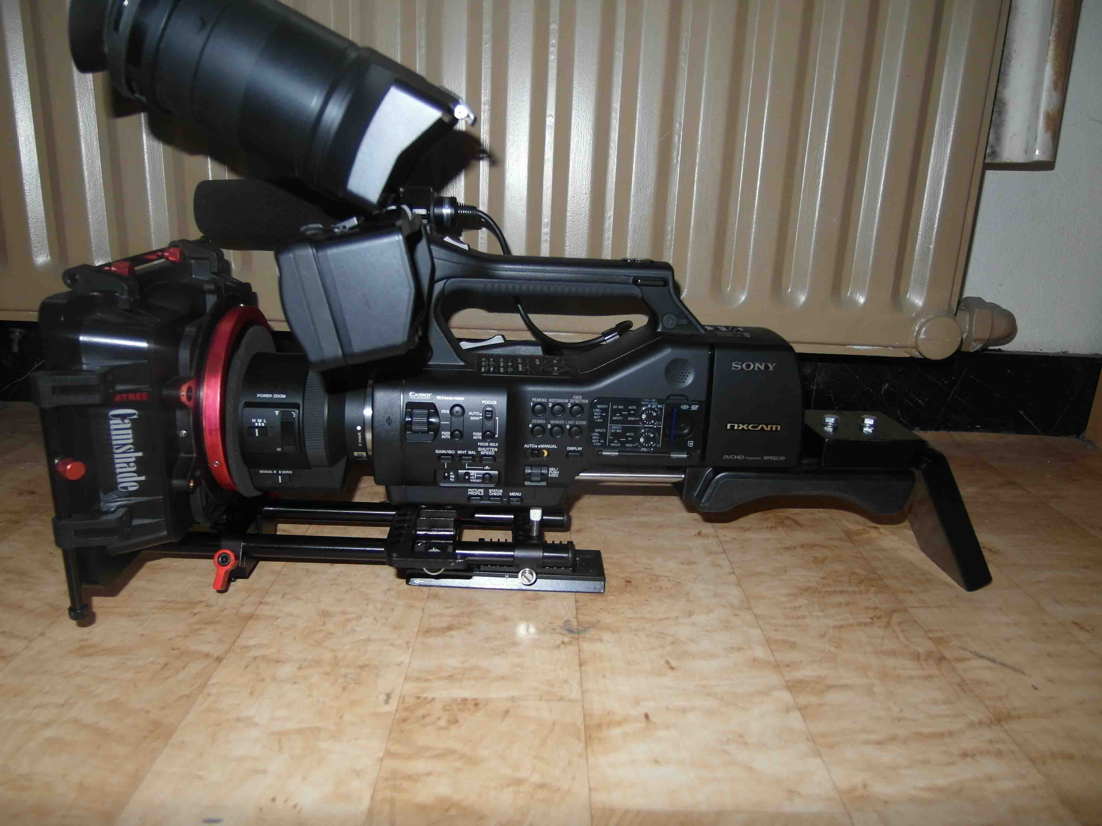

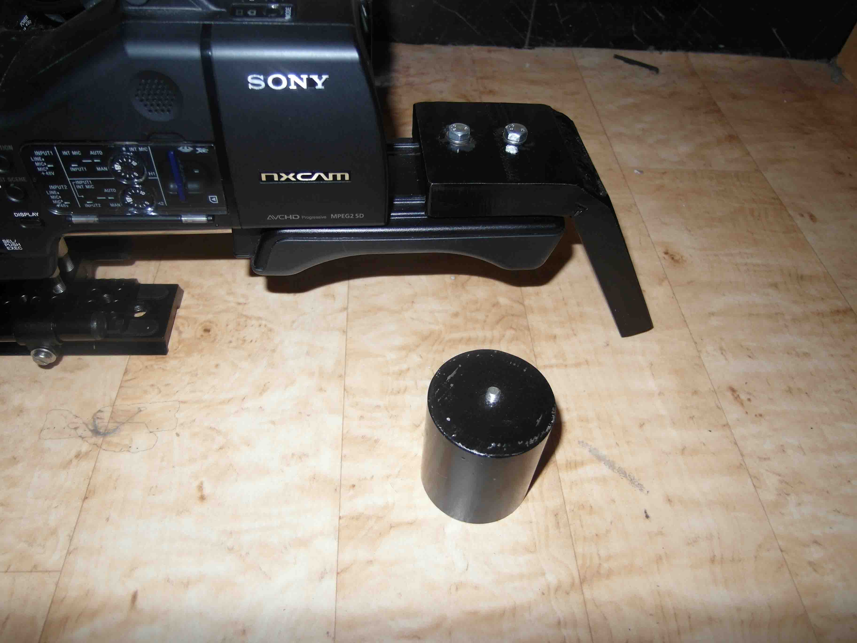

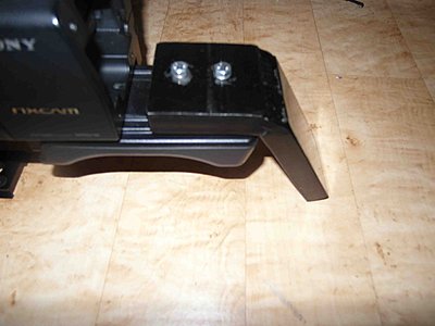

Hey CHris,
sorry for the late reply! I have 2 counter balance weights. All 2 were handmade.
The cilinder one is 1.2 kg and the other one is 2.1 kg.
When I have to switch between tripod and "handheld" (shoulder) I will use the 1.2 kg. That's easier to attach on the shoulder pad with just srewing it in. Also putting it in and out the tripod is easier with only this weight.
When I need no tripod I will use the 2.1 kg. this really helps to put the balance backwards. I think all shouldercams with a fixed (and less heavy lens) will be better balanced than the NEX-EA50.
See my pics. If you have questions, just ask.
BTW, my mattebox is now better with almost the lens in the middle! the metal screw on the bars is really tight now!
Anyone using a counter balance weight?-sam_4067.jpg   Anyone using a counter balance weight?-sam_4068.jpg
