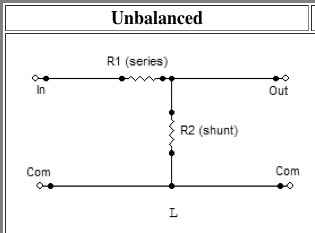

Line Output into VG 20 Microphone Input
Many external Devices have to much Voltage on the Line Output and overload the Input, so its not possible to Record the Sound undistorted.
Here's solution if you want to do it yourself
- 40 db works well tested with SONY PCM 50 D
Uneeda Audio - Build your own attenuator pads
Resistors 2 x 150 Ohm as Shunt at the output and 2 x 7.5 K Ohm in series from the Input
A Finished solution - 25 db Headphone Monitoring without delay!
http://www.bhphotovideo.com/c/product/750963-REG/Sescom_LN2MIC_ZMH4_MON_3_5mm_Line_to_Mic.html
