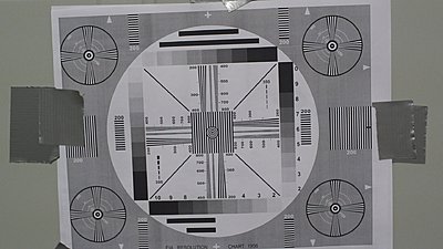

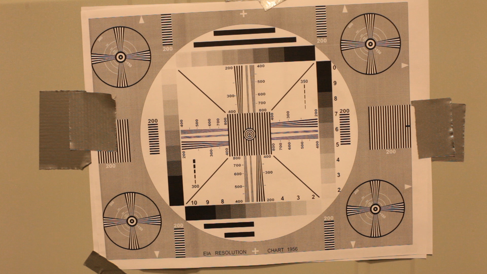

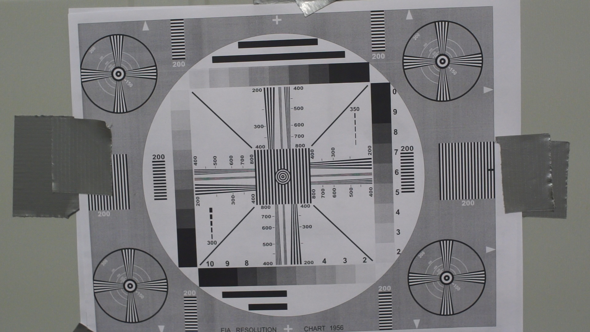

My main camera right now is the 5D Mark II. Today is printed of a chart just to compare the two.
First, I used two Nikon lenses that should be similar in resolving power, to give the cameras the same field of view. The Canon had the Nikon non AI 50mm F1.4 lens, set to F 5.6. The Sony had the Nikon non AI 35mm F 2.0 set to F 5.6. I did have to pull the Canon back a bit to reach critical focus...probably about 6 inches. A
I shot video files from each initially static, then panning. I dragged files into Vegas and grabbed frames to compare. The ones attached are typical. During the panning part of the test, it was clear that the Canon was aliasing so much more that the Sony.
Send me PM email from site and I will give you a link to a YouSendit file if you want to download the chart videos. About 130 megs apiece.

Thanks for posting these. I have the 5D MkII as well, and I do not consider it usable for video. It's horrid, and I think I was the first to post about its aliasing problem because I would have never purchased it if I had known about that problem from other reports. It is a great still camera DSLR, and I have some great L lenses to go with it since I had the original 5D (non video) at the time.
Quite honestly, aliasing is the big worry I had about the VG20 as well, but from your grabs above it seems well controlled, doesn't look like a problem. I think it should be your "A" camcorder and not look back.
