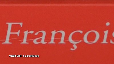

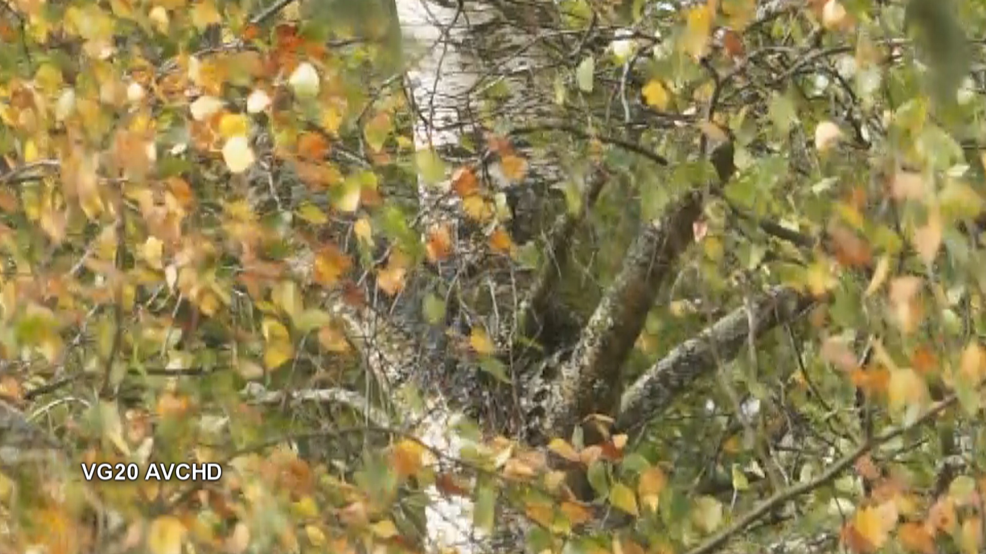

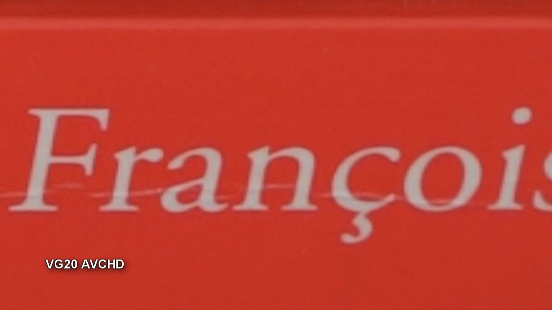

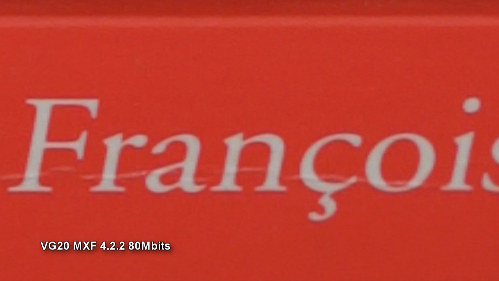

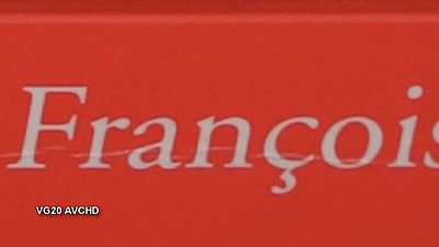

I did some initials tests with my NanoFlash. (Yes, here in France we had a first shipment of VG20)
Signal is clean, and, in my opinion, without processing.
4.2.2 MXF at 80Mbits/s obviously gives more detail and precision compared to the internal AVCHD.
Here are some zoomed extract images from simultaneous AVCHD and MXF shootings
You can also notice suspicious outlines around letters on AVCHD picture.
Since these tests, I also used my Canon 35 L 1.4 + Kipon mount adapter: Here too, picture is better ... This is not a surprise.
Moire and aliasing are sometimes troublesome
(I compared with my 5DII: I would say a little less on the VG20, but still too much for use as "A" cam without any risk)

If it's outputting true 4:2:2 via the HDMI port, that would certainly be bonus, particularly for sfx shooters.
It's difficult to tell much difference in quality just from those screen grabs though (which, by the way, thanks for posting). The only real way to tell might be to aim it at a chart....
