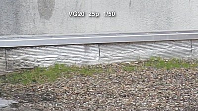

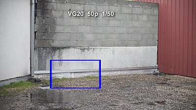

To be honest, here in Europe, 50i and 50p are really suffering from a very important aliasing and moire.
I was about to return my VG20, but I did some tests on 25p:
Good surprise: Aliasing and moire much less present, enhanced details,
and finally, an image quality quite good, in my opinion.

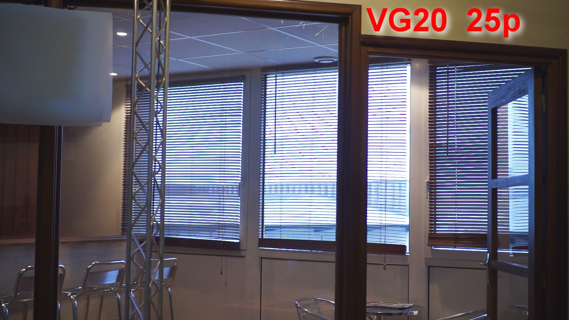

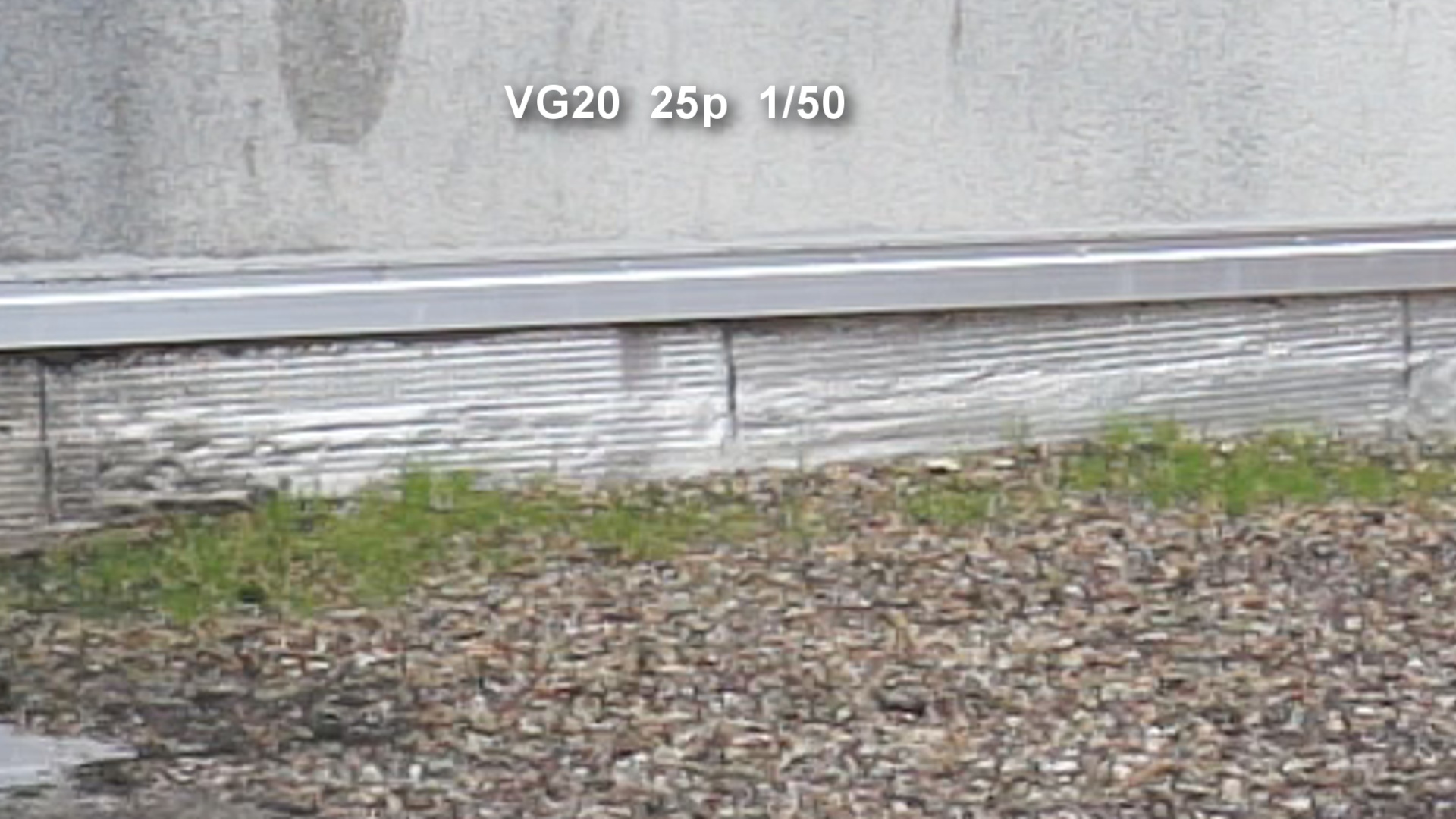

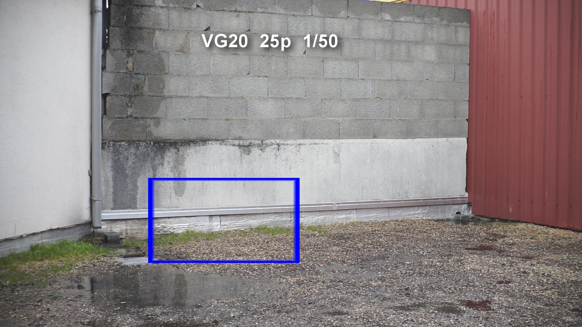

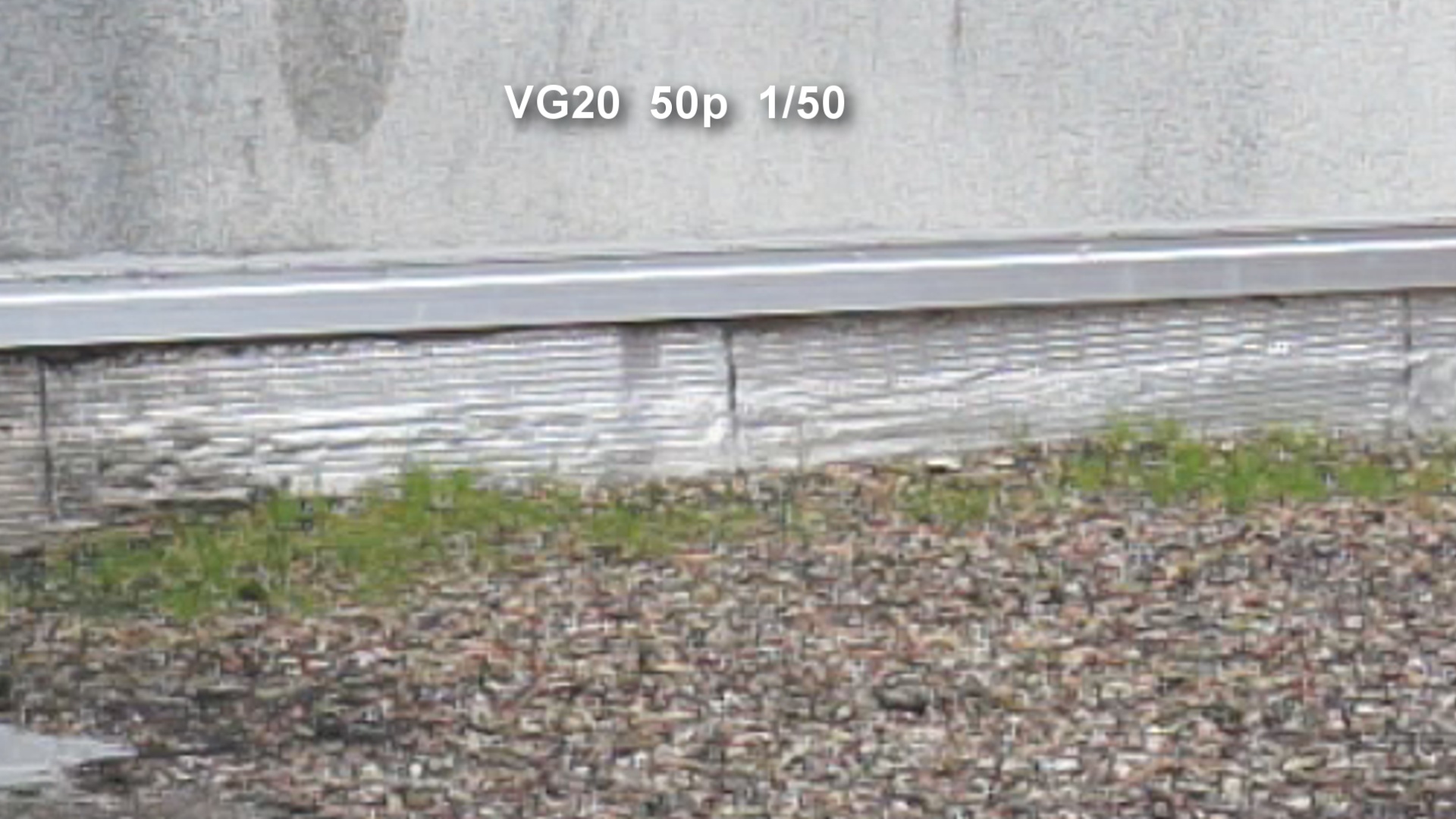

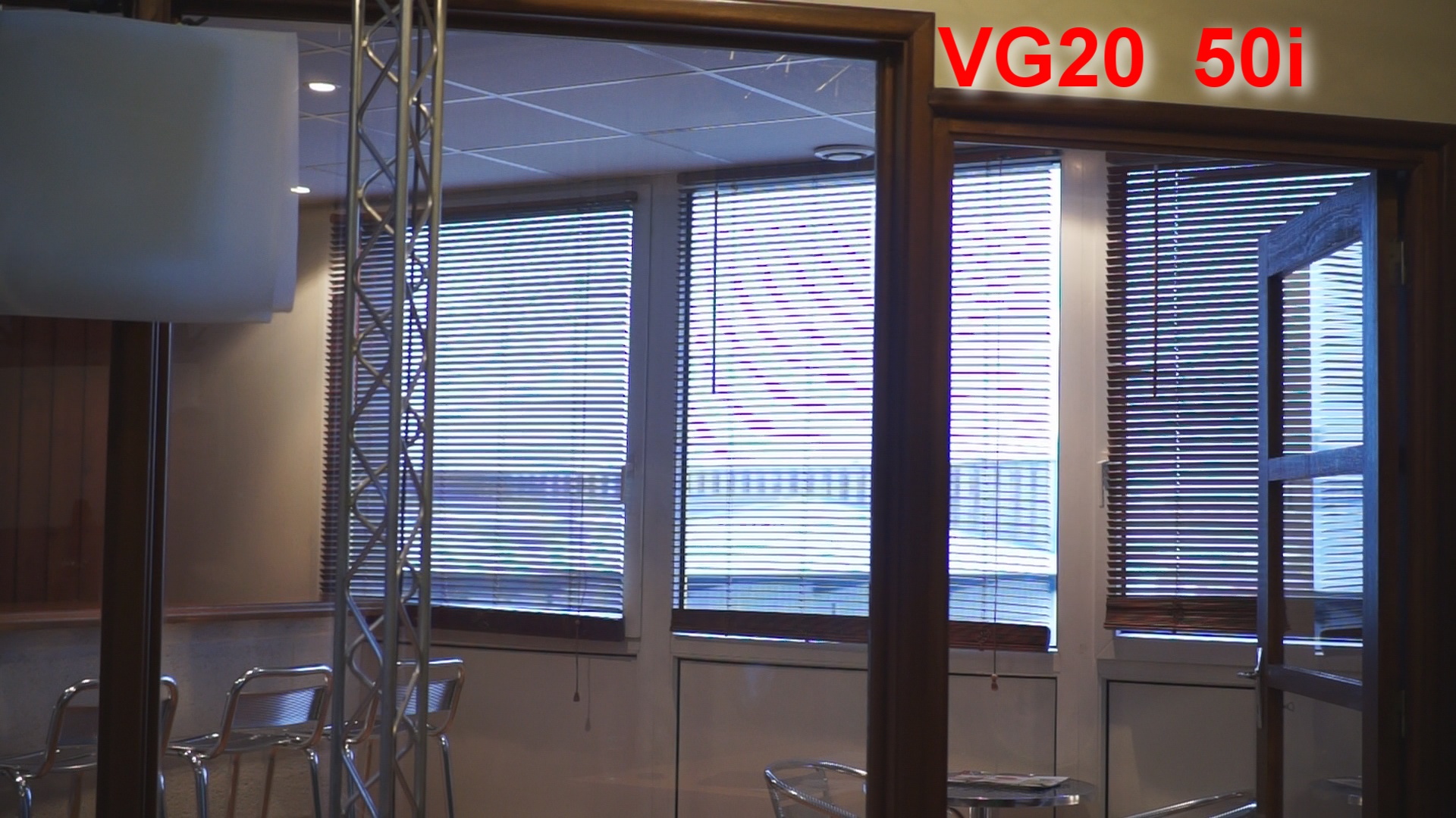

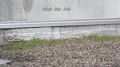

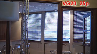

Here are some samples of my "torture tests"
Didier Perrichon is offline   Reply With Quote

The venetian blind photos have the high-contrast edges and show
significant chroma aliasing. The debayering algorithm is slamming
between green and purple and neither is correct.
All of these s35 cameras other than the F3/FS100 are going to have
some degree of aliasing.
