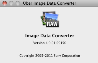

Go to the Sony Site Version 4.0 can open VG 20 Raw Files

yes the Image Data Converter which comes with the camera will convert the raw files to tiff or jpeg. the latest raw updates to Lightroom and Photoshop say they will open NEX-7 raw files but do not read the VG20 .ARW images.
