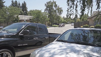

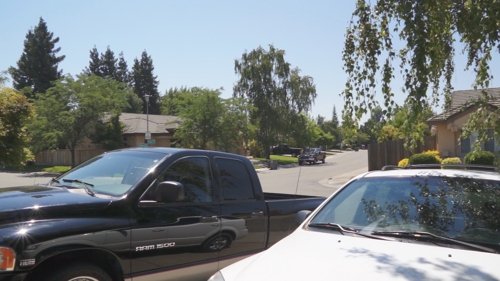

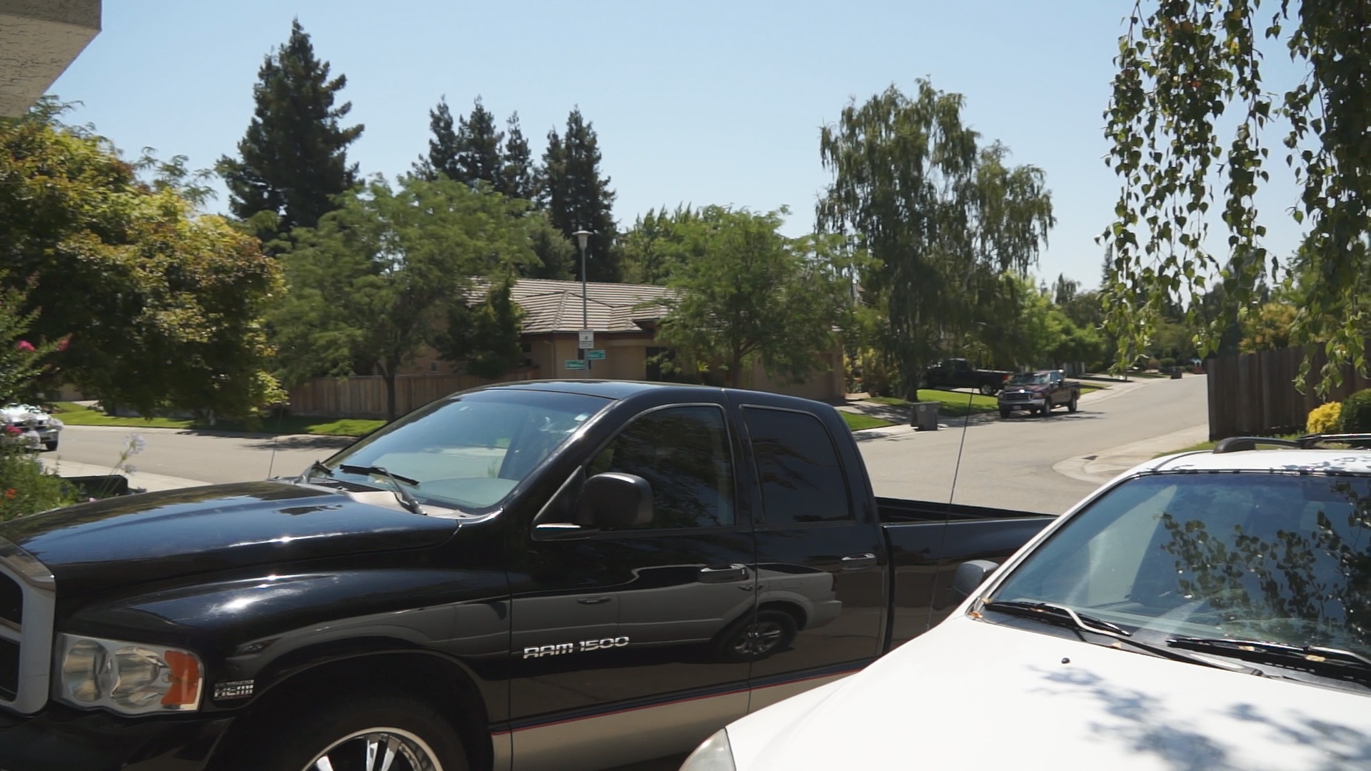

Since I don't have the FS 100, not sure how to respond. Attached are screen grabs from my unscientific comparison of the 5n shot in standard, standard with reduced saturation, sharpness and contrast, and the VG20. Exposure are probably not equal, so that is a problem, but maybe it will give you some idea.

Thanks Chris, that's exactly what I was looking for. Interesting how much more shadow detail you get with everything turned down in the 5n. It'd be a no brainer if you had the same picture settings of the 5n, but now I'm not so sure. Hmmm...
