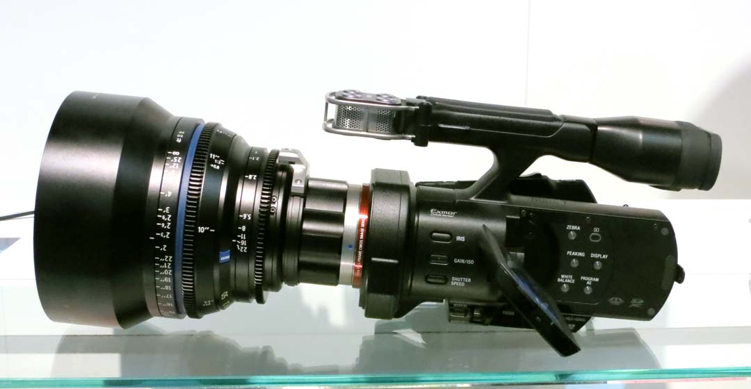

Here is a photo of the VG900 withFF Zeiss 50mm Cine lens with NEX E mount :
