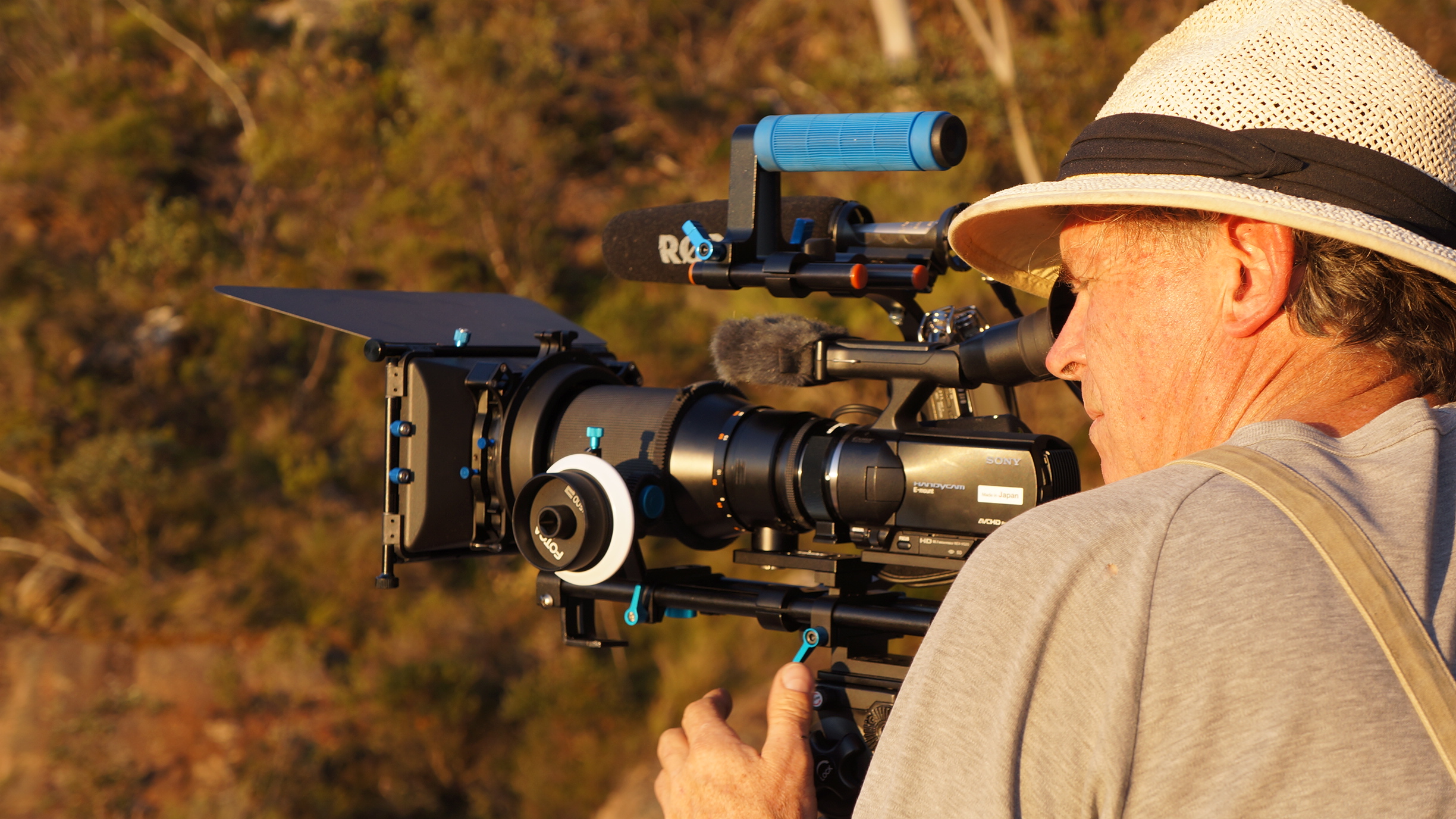

You may need to adjust the Speedbooster's back focus. Mine was a tight fit on the VG20 till I set the back focus, now it is perfect.
