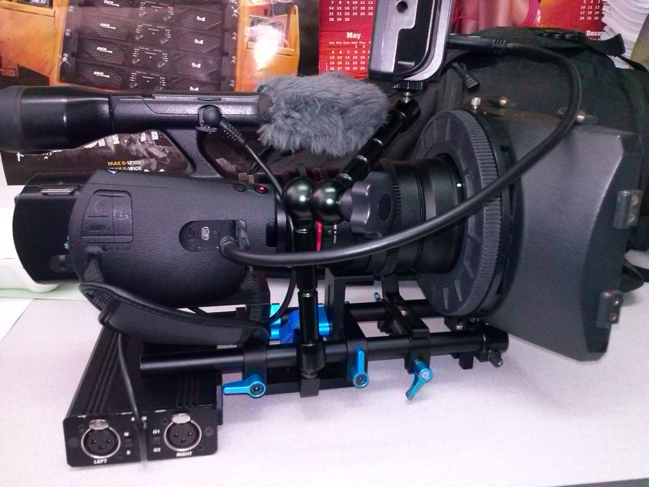

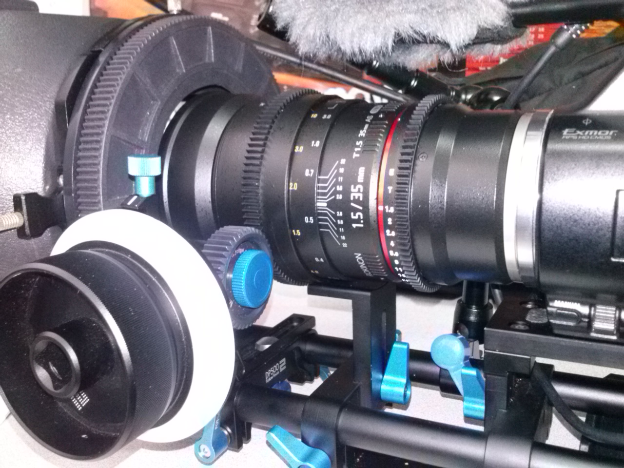

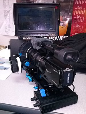

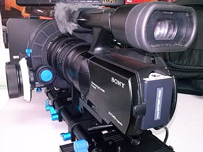

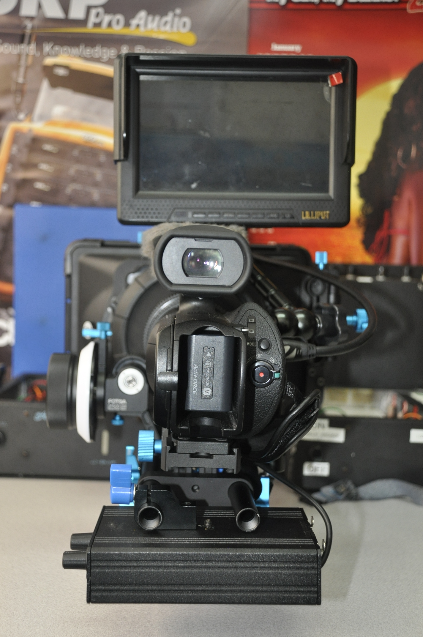

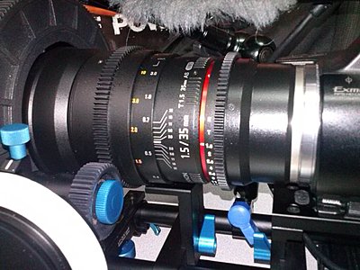

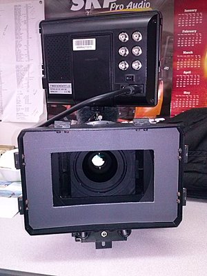

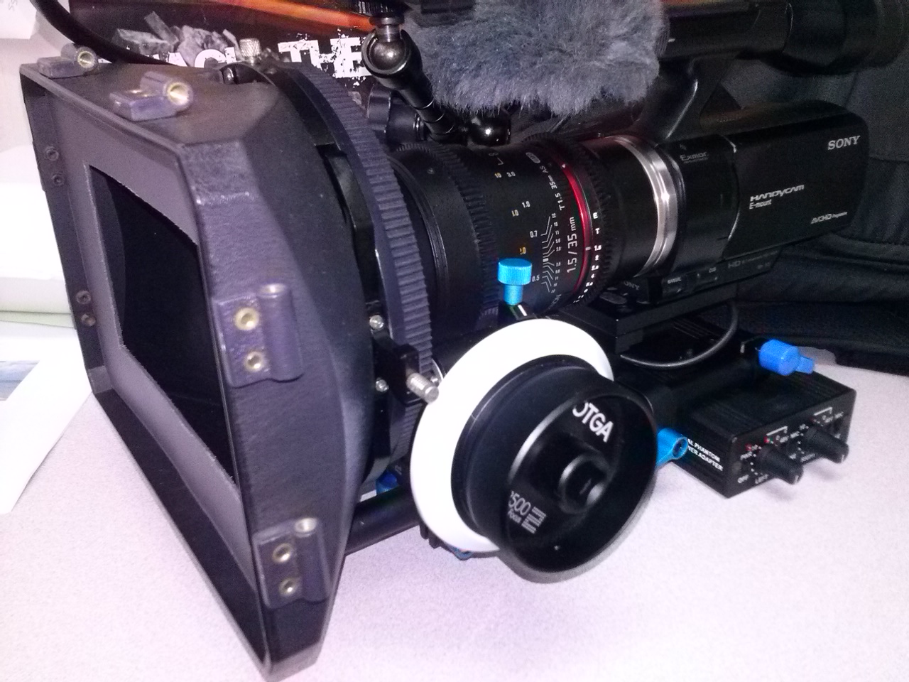

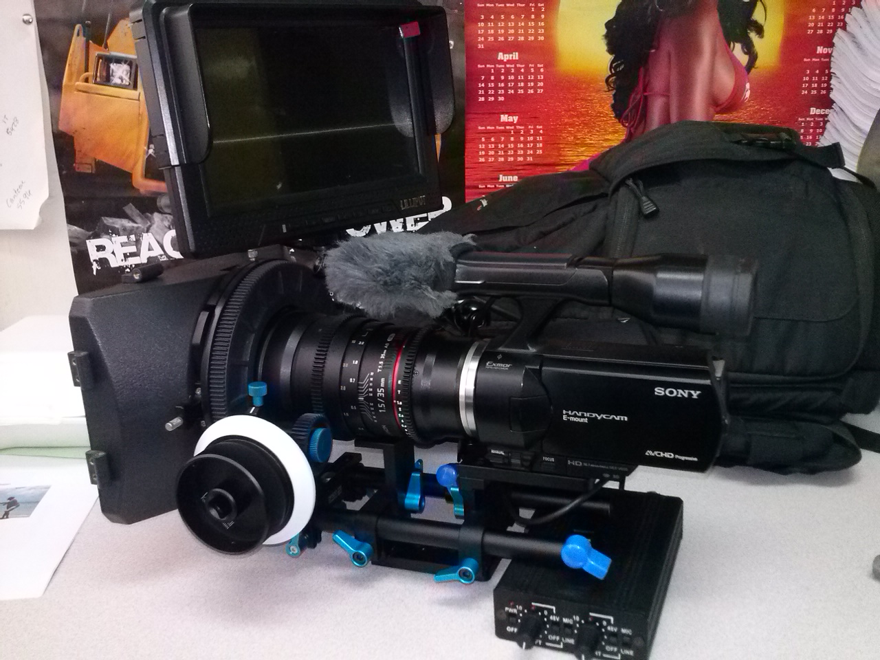

I Finally got the Rokinon 35mm T1.5 Cine Lens for Sony E mount ,here are a few pics of the rig im building

Cool! Great lens, I really like using it.

Its fantastic , i will never go back to regular glass , primes all the way , i will be buying the 85mm next

Nice rig. Could you let me know what you have attached as an audio recorder and how you attach it to the camera and tripod? Many thanks.

No audio recorder as yet i still record in camera ,but im looking at the Tascam - DR-60D 4-Channel Linear PCM Recorder from B&H

Nice rig - James what magic arm do you use - I'm using a fairly cheap one and my monitor keeps working it's way loose.

I bought it off ebay here is the link
11" Magic Arm for Lilliput 7" Monitor DSLR Camera Light | eBay

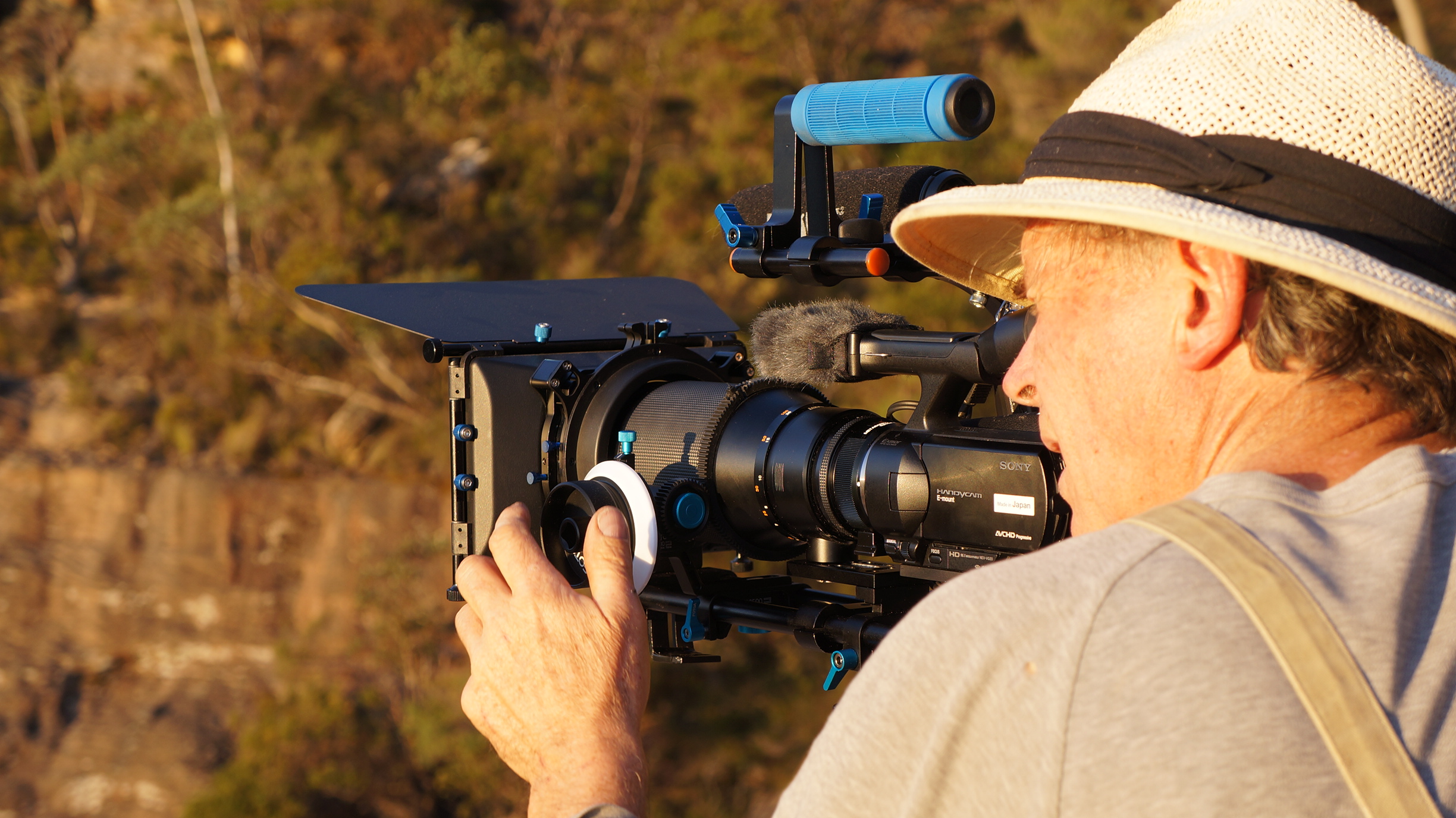

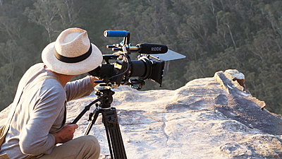

I'm using a similar setup with similar equipment but with Zeiss primes coupled via the Metabones Speedbooster to improve the contrast and add that magical extra stop. The Tascam DR-40 4 track PCM recorder provides phantom power to the Rode NTG-3 and records 'ambient' via it's on-board stereo pair. I also run an audio feed from the DR-40, direct to the Vg20's aux input for a 'camera' copy of the mixed 4 track recording.

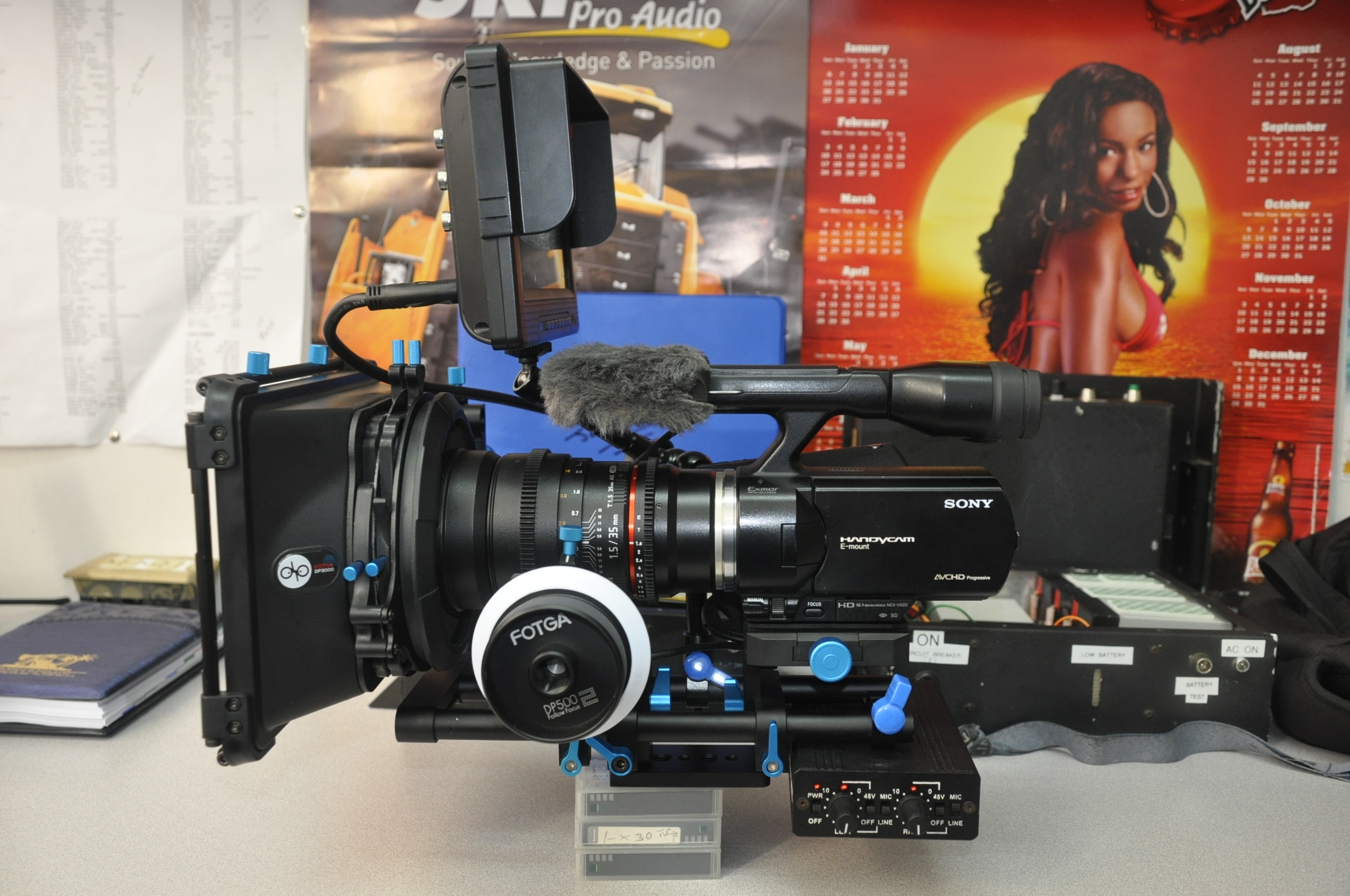

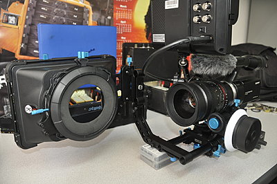

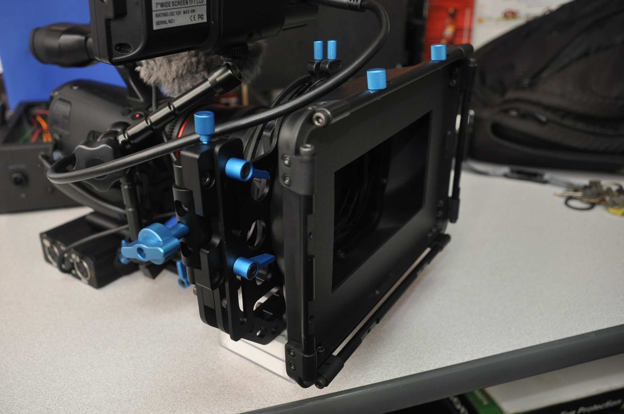

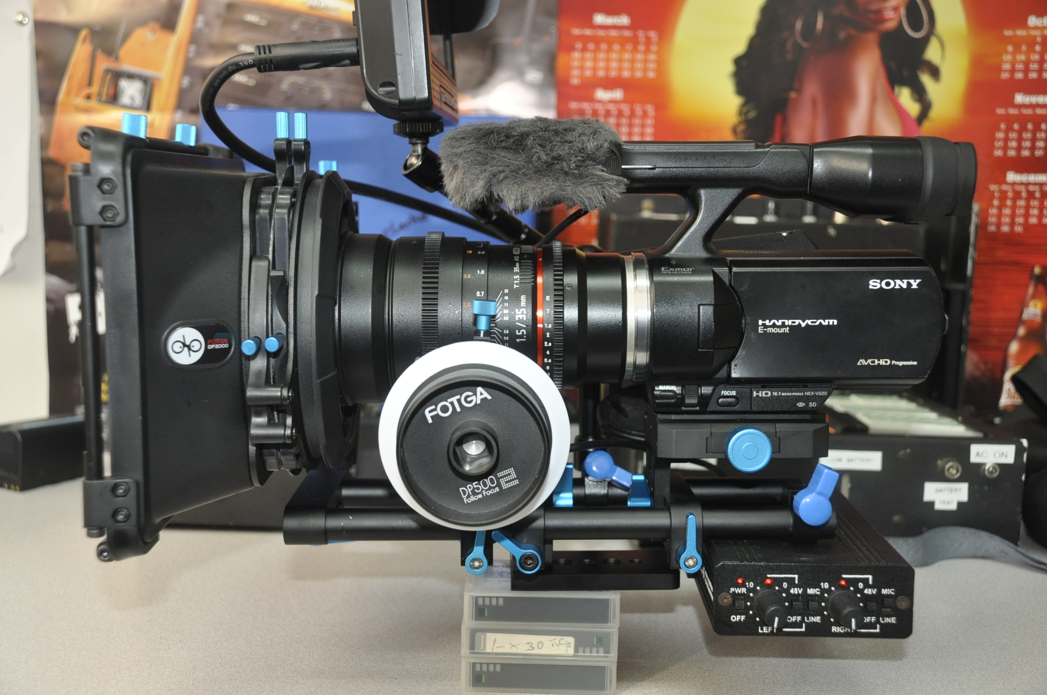

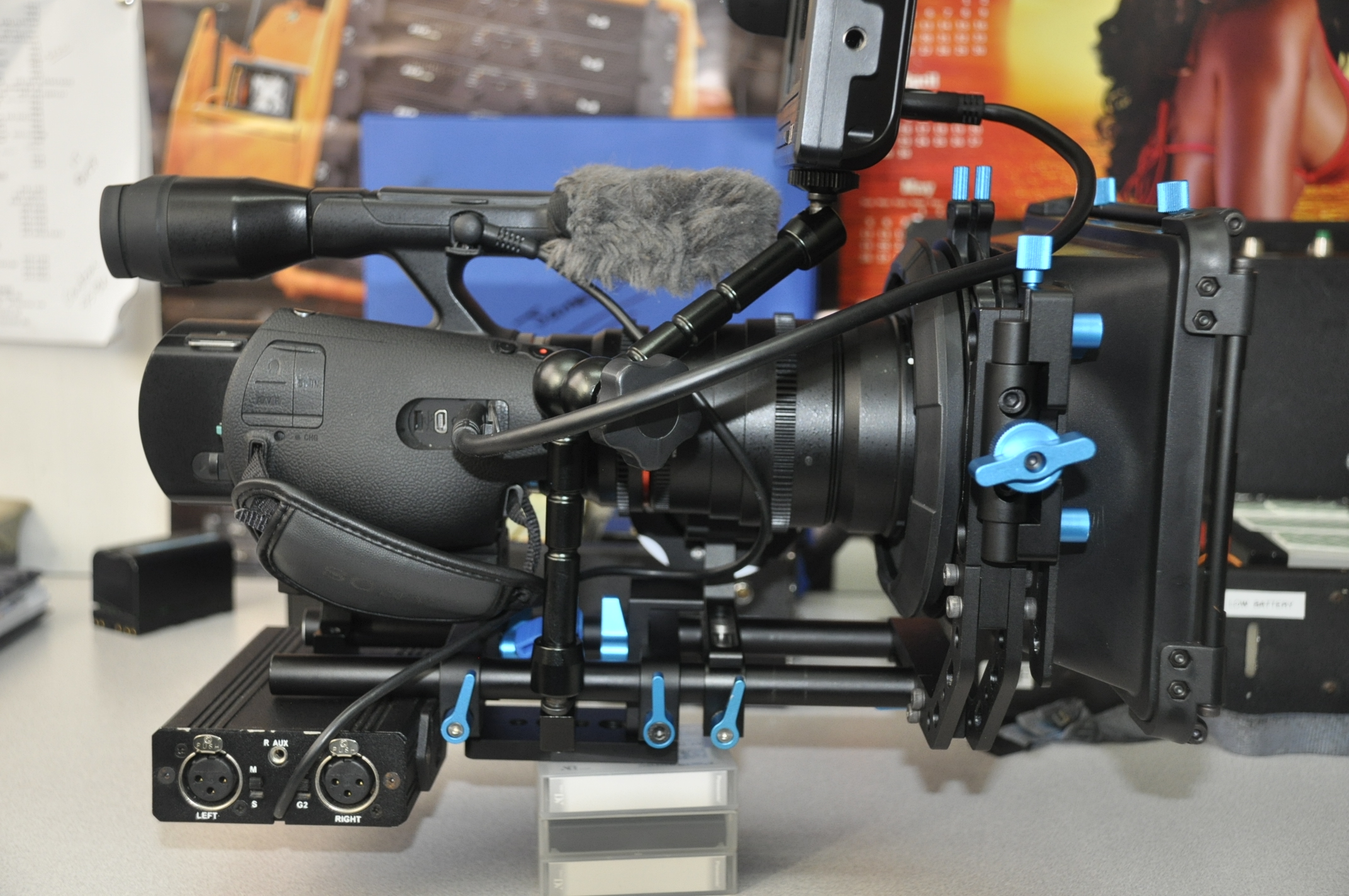

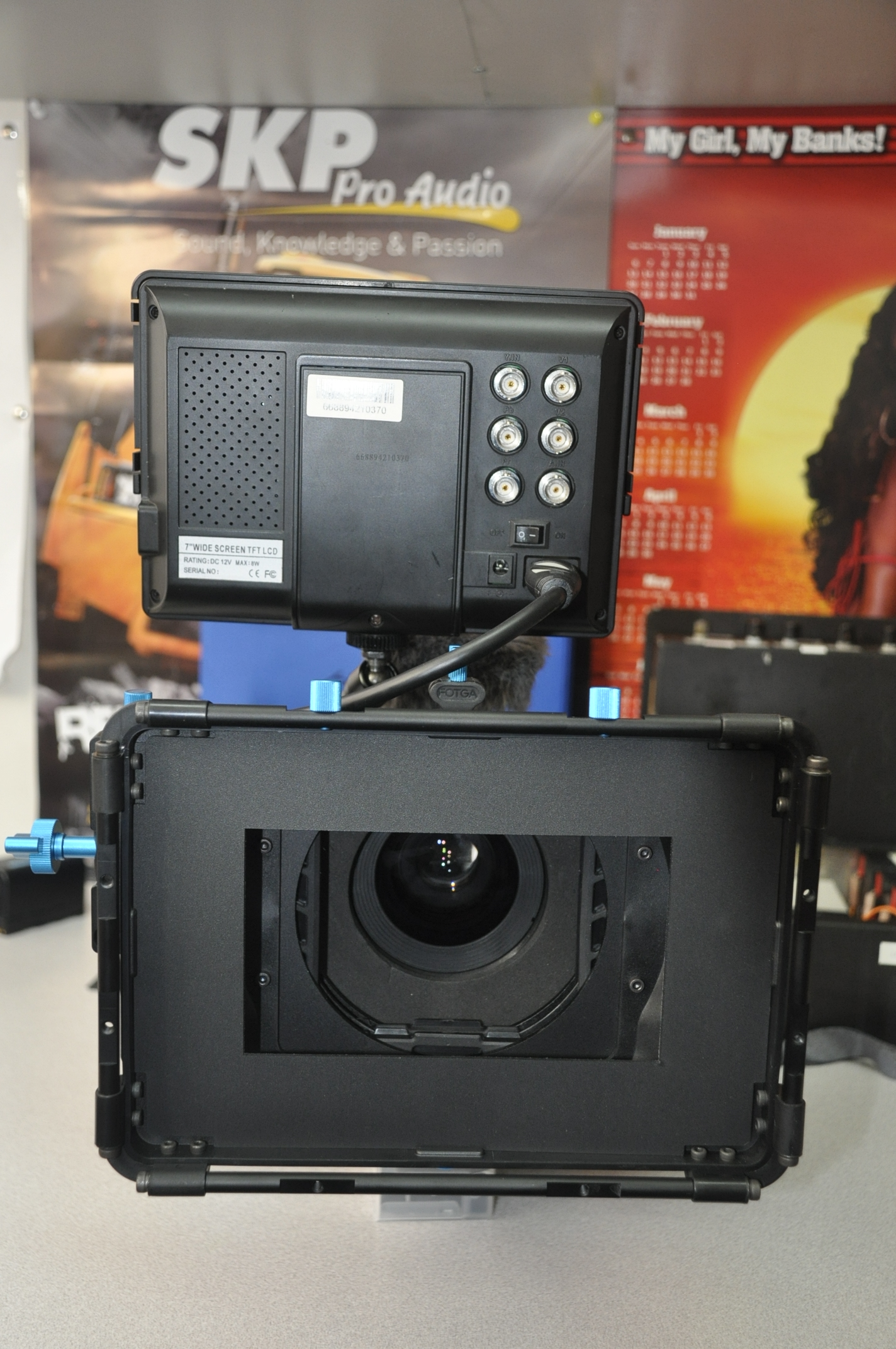

Hi I just upgraded my matte box with the Fotga DP3000 to match the rest of the rig here are a few more pics

I like the 'swing out' design of their new matte box as it will speed up your lens changes. James, is the Rokinon 35mm a 'full frame' lens or APS-C/'Super35'?

the rokinon 35mm provides full frame coverage.
