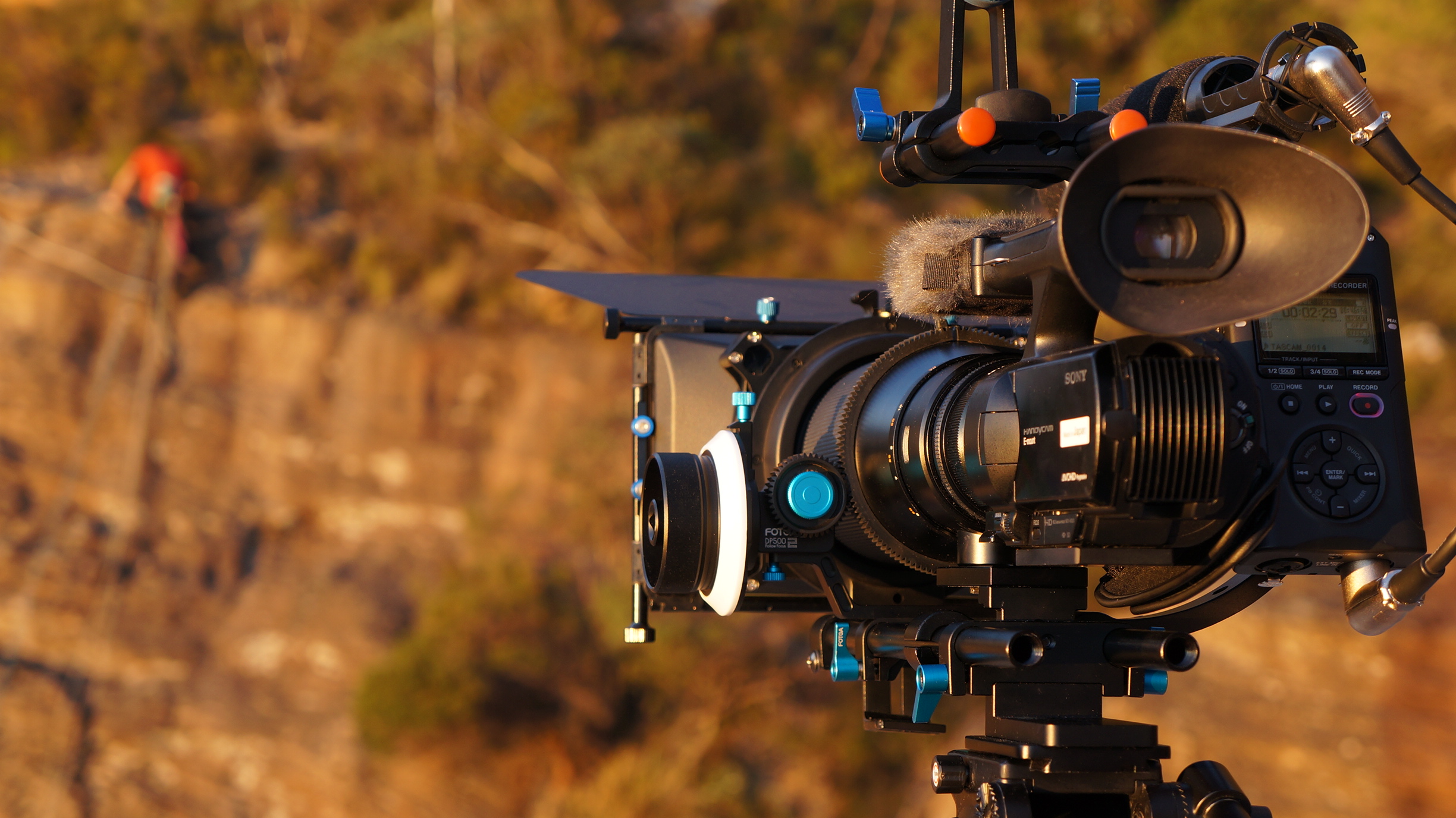

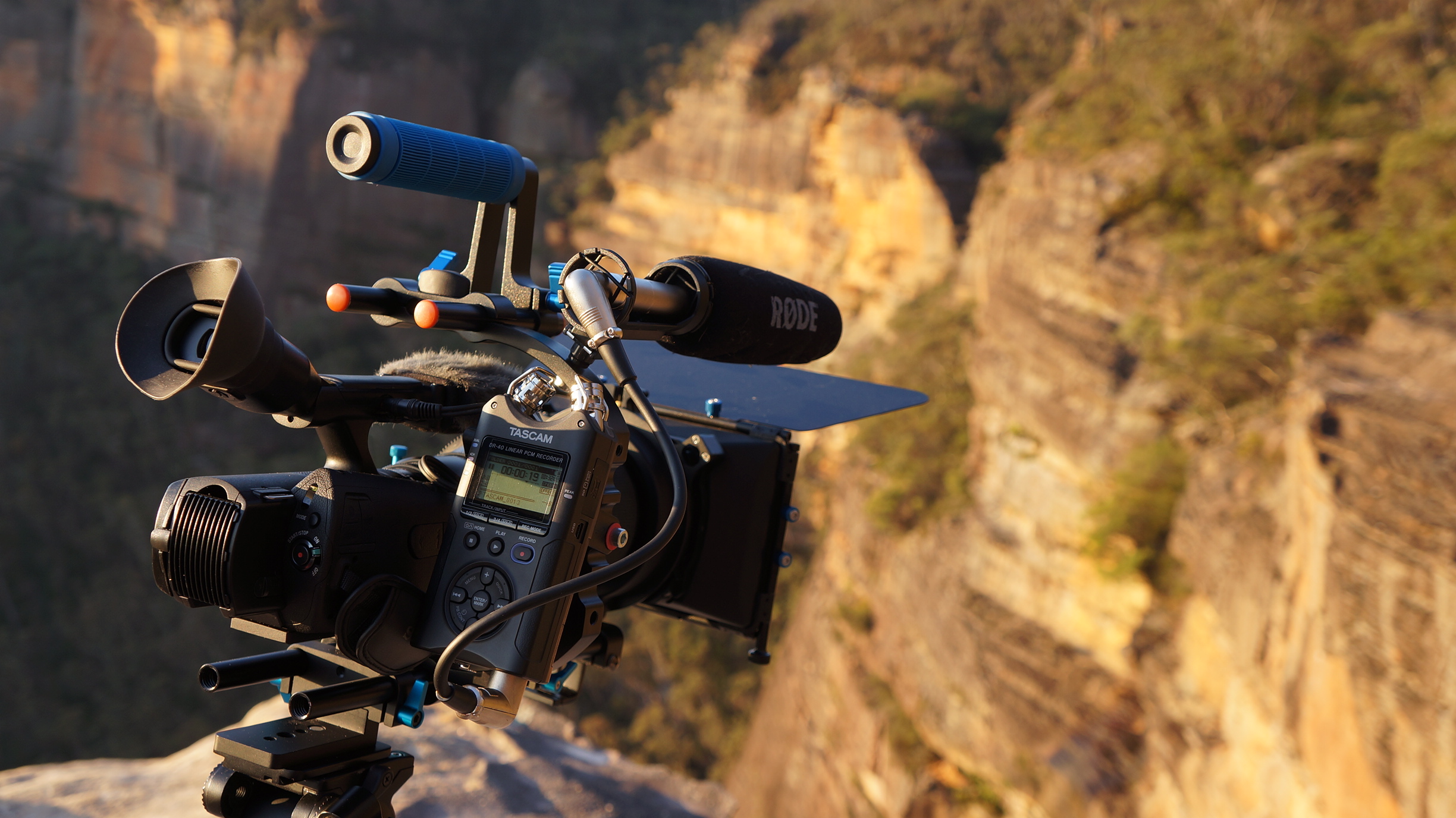

Yes, when you plug in an external source, the camera's internal mics are disabled so when I use the DR-40 as an external recorder, I set it up to record two tracks from the Rode NGT3 and the second pair of tracks from it's own pair of condenser microphones. (as 'atmosphere') (Note: DR-40 is a 4 track recorder) From memory, the DR-40's monitor output can deliver the sound of either pair of tracks (or a mix) to the Vg20/30's aux input.
PS: I also use a resistor pad in the stereo mini-jack cable to reduce the DR-40's output to better match the camera's aux input sensitivity.
