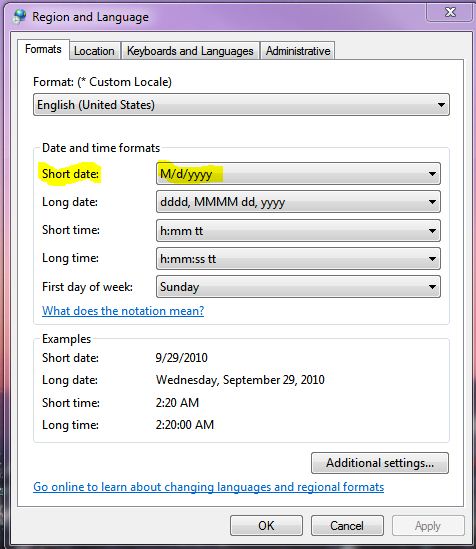

What you need is just to change the date format of your copy of Windows (this is what Ron Evans suggested before).
To do so, open Control Panel, go to Region and Language setting. There you can change Short date format from M/d/yyyy locale (which presumably you have now) to yyyy-MM-dd – the format you asked for.
I enclosed a screenshot of this setting to facilitate your task.

Posts: 28
Done. Now I need to check it out. Will let you know it worked.
