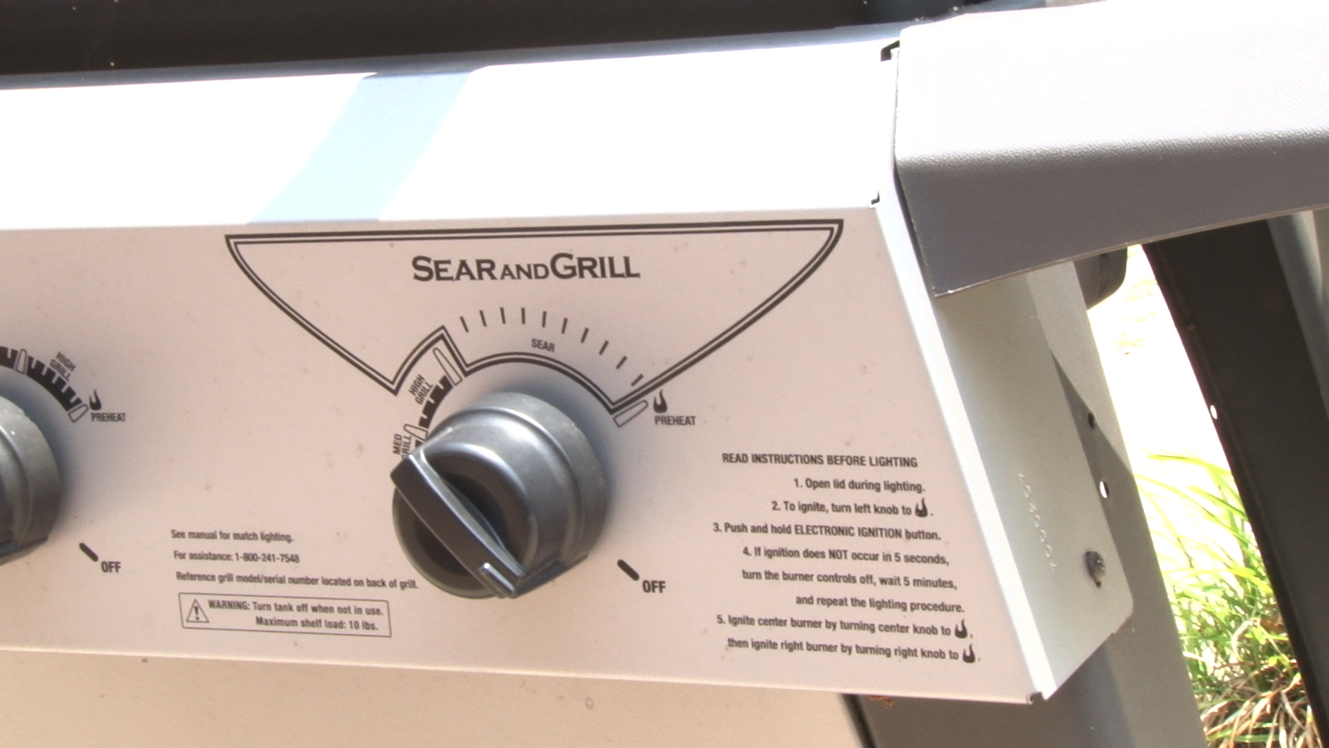

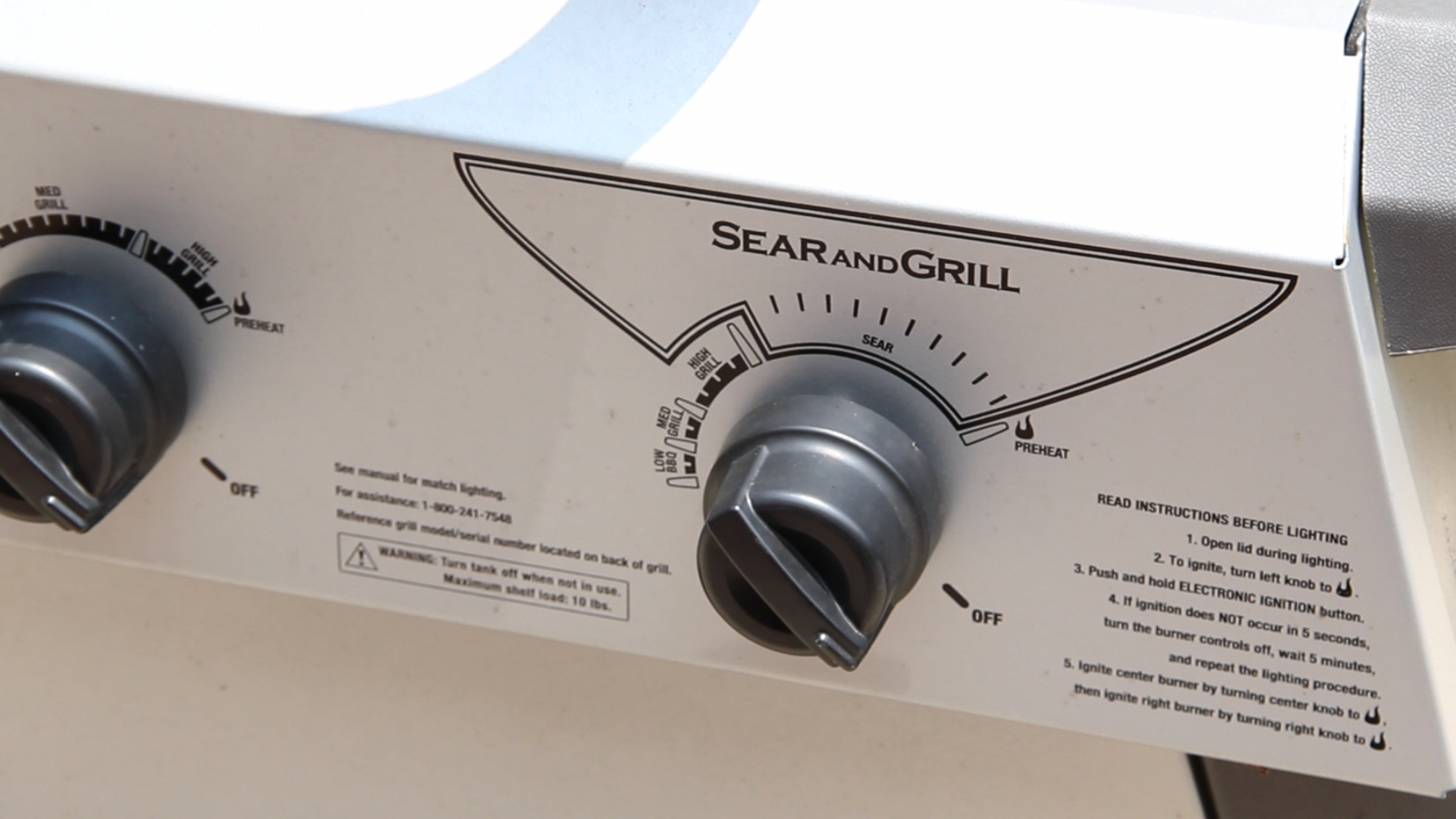

Well, I've run some more tests and I'm convinced the ND filter is in fact causing some of the grain issues. The ND filter seems to increase the amount of grain with each level. However, it's not just the ND filter... (see images below).
You can clearly see the difference in the amount of grain in these 2 stills (both taken in bright sunlight). No ND filter in the NX5 shot and it's still grainy. The images do seem to be quite better indoors with good lighting, but overall I'm just not satisfied with the images from this camera; especially not for the 4k price tag. I'm 1/2 step away from trading this camera in, but I want to evaluate the rest of my footage, along with the other available cam options out there before making that decision.
After talking to Sony's tech support, I feel fairly confident that the IQ I'm getting is not from a camera defect. I think it's just the how the NX5's quality is. If anyone here has any high quality images they can post up from this camera to show otherwise, I'd sure like to see it.
