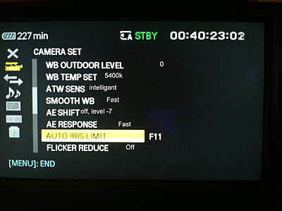

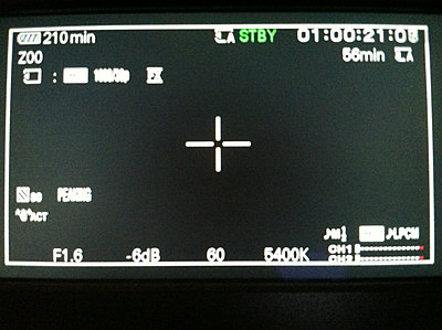

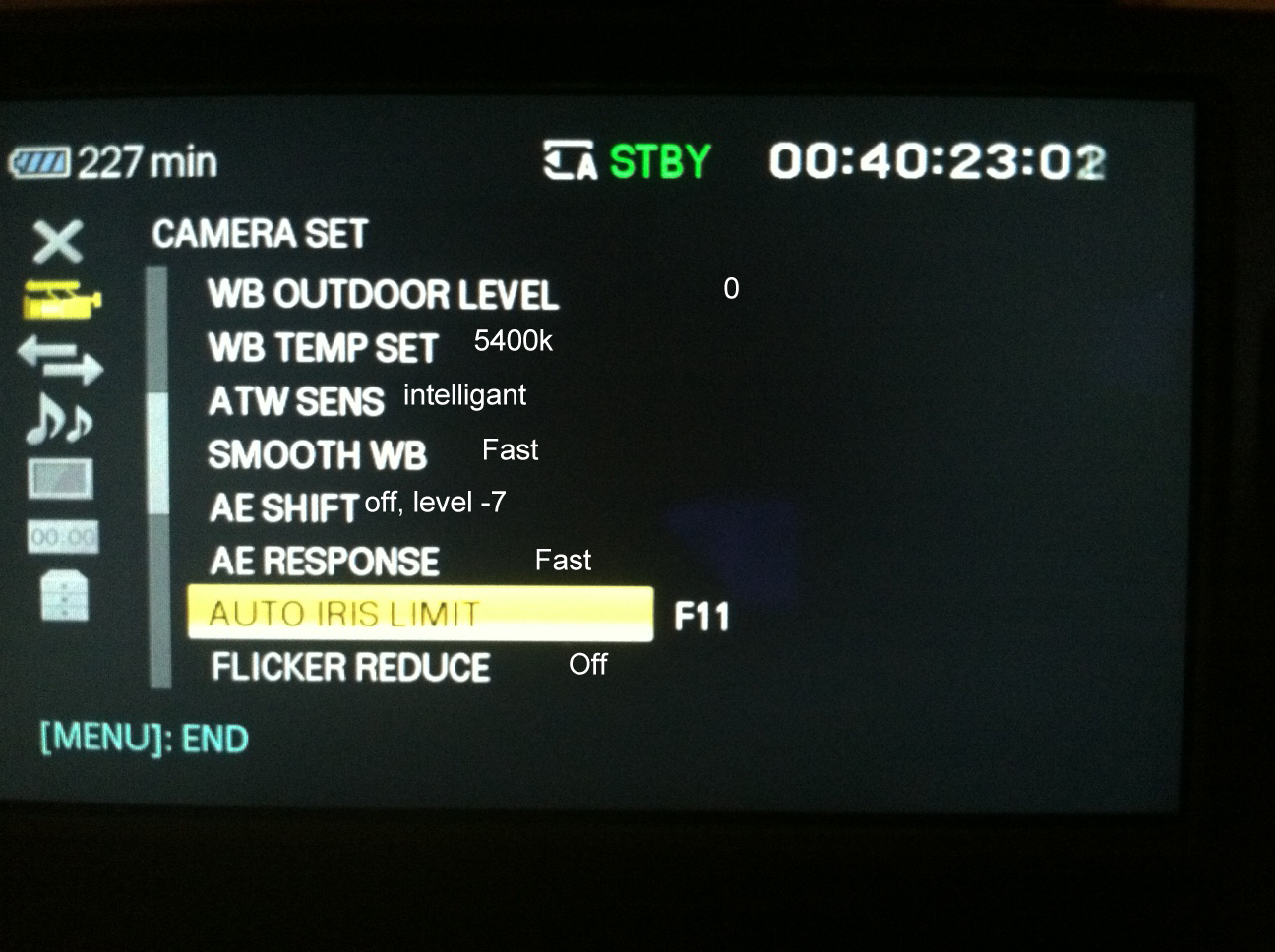

Location: Chicago Illinois
Posts: 102
Re: NX5U grainy picture possibly resolved with Plugin

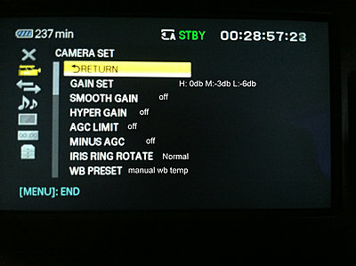

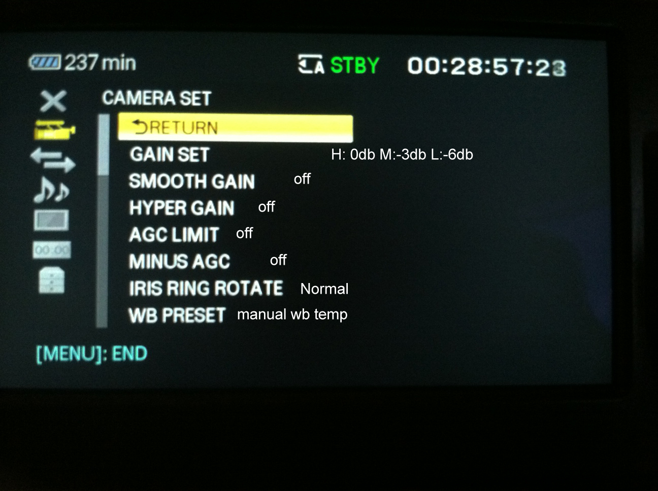

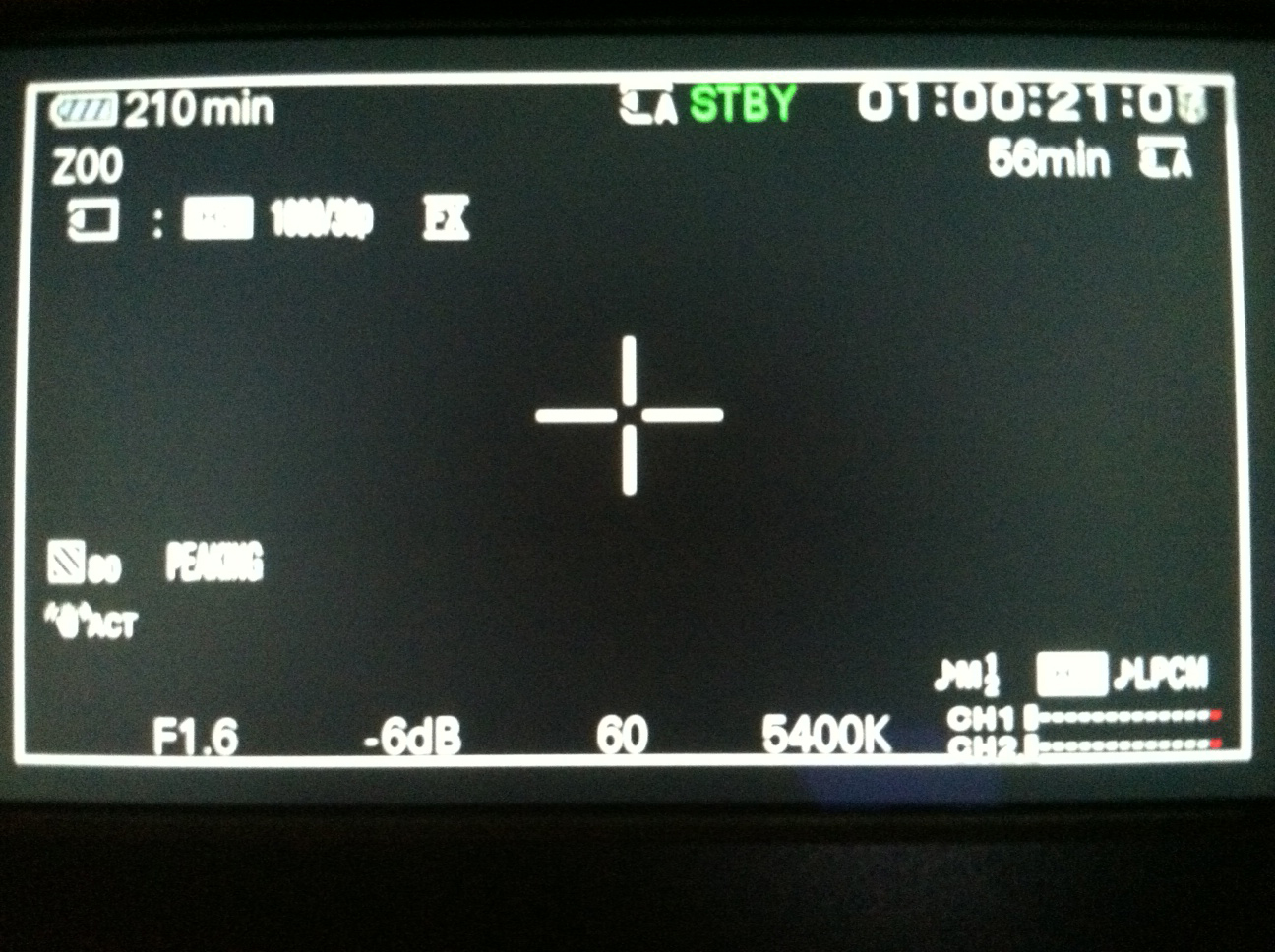

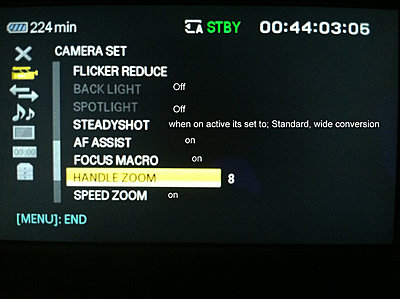

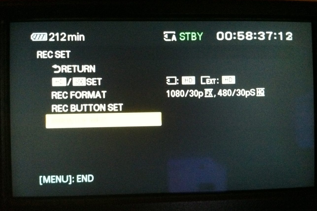

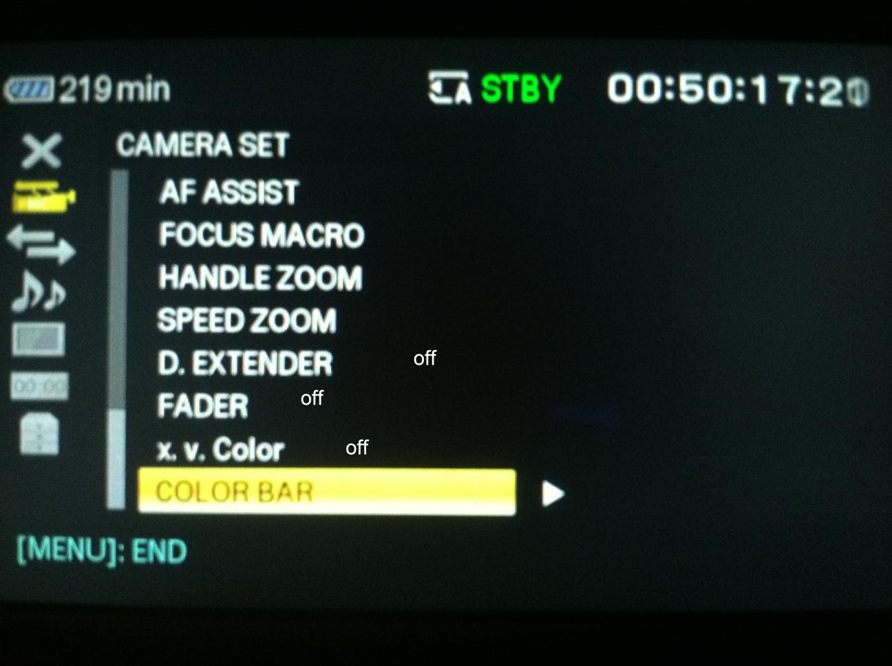

this is what i was able to come up with, i hope its enough info. i didnt include an PP because i get this problem without pp too.
NX5U grainy picture possibly resolved with Plugin-nx5_menu_1.jpg   NX5U grainy picture possibly resolved with Plugin-nx5u_menu_2.jpg
NX5U grainy picture possibly resolved with Plugin-nx5u_menu_3.jpg   NX5U grainy picture possibly resolved with Plugin-nx5u_menu_4.jpg
NX5U grainy picture possibly resolved with Plugin-nx5u_menu_6.jpg   NX5U grainy picture possibly resolved with Plugin-nx5u_menu_7.jpg
Mike Butir is offline   Reply With Quote
Hey Mike,
Thanks for posting the screen shots. Honestly, I'm at a loss for your noise issue. Perhaps someone with more knowledge might chime in. Your camera is setup very similar to mine and the slight differences between our setups aren't going to cause the grain you're seeing. I'm really scratching my head right now for ideas. As mentioned in my previous post, both of my NX5's (with virtually identical settings to yours) do indeed record a grain or noise free image with or without picture profiles and thats even before it's imported into an NLE. I wish I could provide more help but I am truely out of ideas. Keep us posted if you find a fix. Perhaps Sony might have something to say about it.
Michael Bray is offline   Reply With Quote
