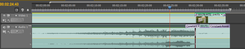

Here on this side of the pond diesel locomotives have super loud horns that can easily leave the audio distorted as the horn is blasted. On my Canon GL2 I set the properties to mic ATT and that got rid of it. With the NX70 I see there are multiple ATT settings.
Which setting would help reduce the distortion created by loud horns using the supplied Sony shot-gun microphone? I left mine at 10db and I plan on shooting some trains sometimes this week. Would that be the correct setting?
-Eric

It's trial and error. I'd probably put one channel on auto and one on manual with Mic att set to -20db, you should get something usable from that.
I can't remember if setting the attentuation affects the auto settings. You could try one at -20 and one at -10, and make "airhorn" signs at the driver to see which is best!
As usual, trial and error counts for a lot here.
I've attached a screengrab from Premiere Pro of a bit of "horn" on one of my videos. You can see the two waveforms, one from the mic on auto (L) and manual, with -10db (R). In this case, I opted to choose "Fill right" and use the manual channel, because it sounded better to me.
