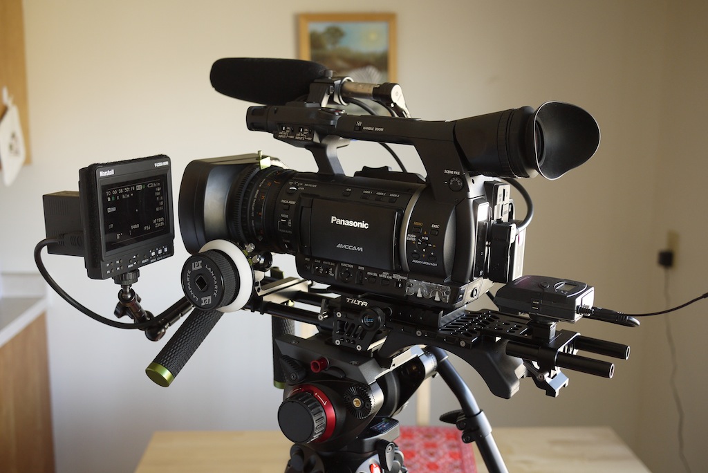

I got a new follow focus in the mail today, so your post caught my eye. While I purchased the FF for my AF100 lenses, I just set up my AC130 on the same rig - similar to the NX5 if not just a bit bigger.
Nevertheless, it works just fine, but as mentioned, there are a few things that you need to be aware of:

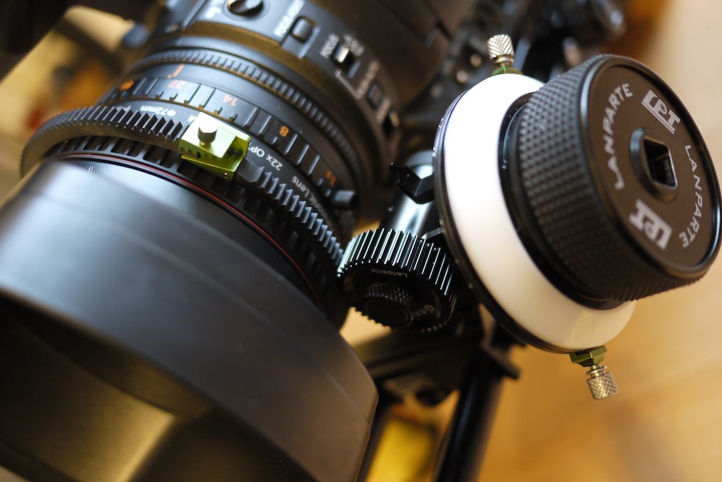

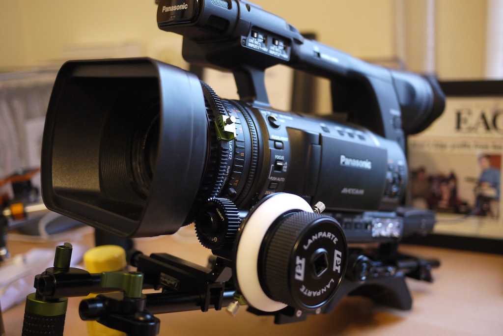

1) Make sure you get a follow focus that has a gearbox that can be flipped to either fore or aft, otherwise the lens hood will get in the way. In the picture you can see what I mean. If the gear was on the side closer to the back of the camera, it wouldn't fit. I needed to flip it to fit the Panny.
2) You'll need a gear ring, but since the focus ring on a camcorder is so much larger than say a SLR lens, I would recommend you look into a form fitting type, sometimes called a "zip-gear." The ones I got from Lanparte are pretty close to perfect, but there are many brands.

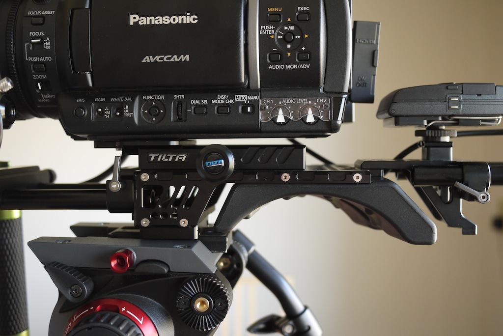

Thanks, I just got it actually. It's the Tilta BS-03 Baseplate - about $300 including rails. The grips are Lanparte, about $95 (really nice!), and are surprisingly solid. Lanparte Follow Focus is quite nice as well. Not sure if its up to par with a zacuto, and certainly not a O'Connor/etc, but sure seems smooth to me.

Though the photo shows the FF on the AC130, I've never really used one with that camera! However, now it know that it does work. Perhaps it might be useful for shoulder mounted operation and setting hard stops for focus. Sometimes it can be difficult to see on the 4" LCD if a 1/3" camcorder is in focus or not. Having a hard stop for the maximum focus distance (like during an event) and a minimum focus distance (front of the stage) might be pretty useful....
The main reason I use a FF is for lens operation on my AF100 camera. Things can get pretty tight with lenses, cables, monitors, rods, etc, and it gives a nice solid part to accurately rack focus. Typically I'm shooting corporate and web content (with lots of shallow focus B-roll), but also really enjoy doing short films - one of ours actually just swept a local Minneapolis film festival, best picture and all. Pretty excited about that!
One of the reasons I upgraded my baseplate and FF is because I like the speed and flexibility of shooting handheld, but needed something that gave me rock solid control over the camera and focus. I'll post some more photos of the rig I've concocted...would you prefer to see the AC130 or the AF100 on it?

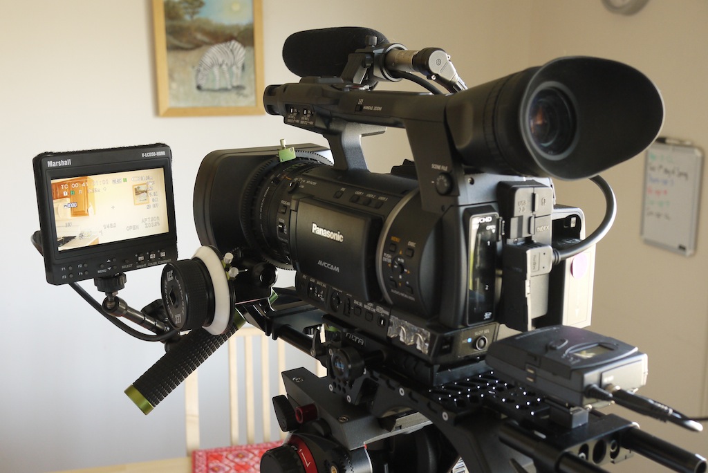

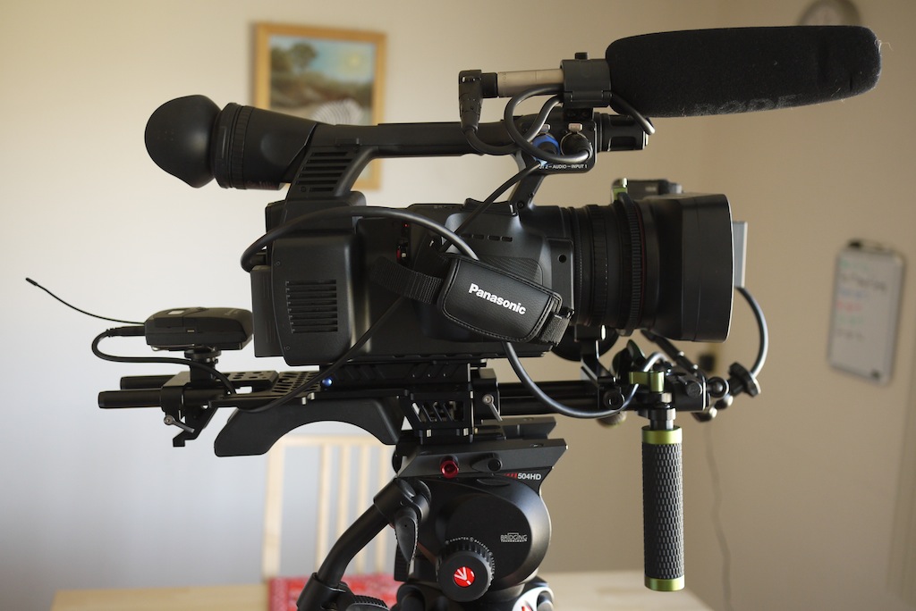

Photos attached.
