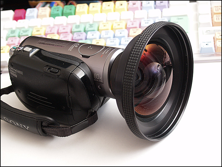

Guess I'm the man who should talk to you James as I have three of these Bolex Aspheron wide-angle adapters. I've bought them all direct from Bolex in Switzerland and have used them on my VX2k, my Z1 and now the NX5. It's a pretty expensive 0.55x single aspherical element, designed originally for the Vario-Switar 12.5 to 100mm lens for 16mm film cameras.
The lens worked fine on the VX2k because that had a feeble 38?mm (equiv) wide-angle. It also was good on the Z1 which started out with a 32,5mm lens, taking it down to 18mm. The NX5 starts out with a 29.5 mm lens so the Aspheron makes that just shy of 16mm, and this is impressive as it still leaves you with a zoom that goes from 00 to 76 yet gives zero barrel distortion.
But sad to say that although the centre of the image is very sharp the corners aren't so good, and zooming up to 20mm (say) doesn't really help - the CA is still there. There's something about the design of the G lens that the Aspheron doesn't really like, and I don't know what it is. Not that this matters for a lot of shots where the effect rather than the resolution is what you're after.
Shame really, as it's a very powerful wide-angle giving you huge control over perspective distortion. It's a single element that's beautifully T* multi-coated so flare levels are well controlled. Impossible to hood I find.
