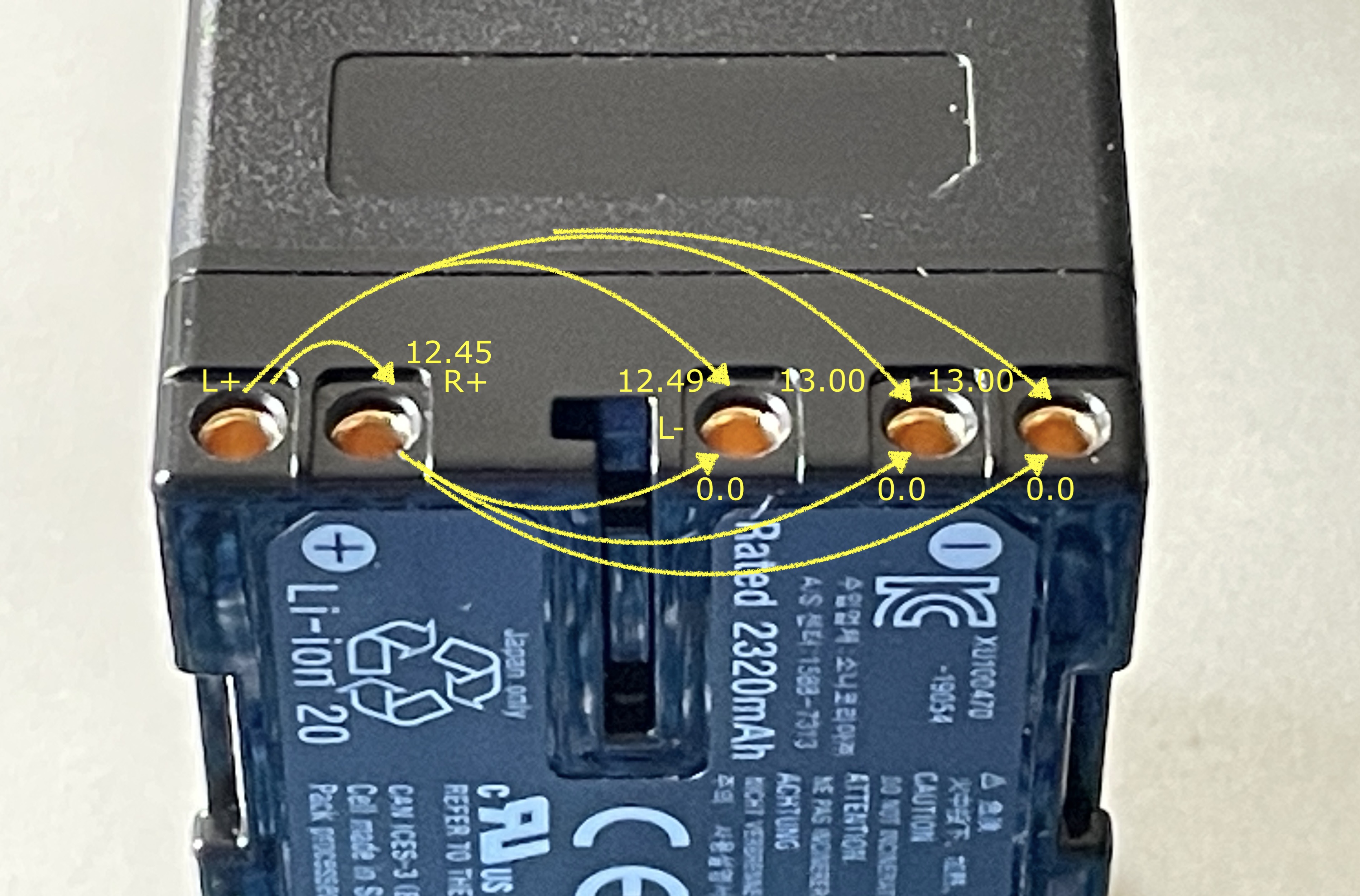

The camera would not turn on so it was connected to the AC charger overnight but no change; however, it still would not turn on. Question: is the battery dead? As in, “toast”? The battery was removed from the camera and tested with the Charge Button on the battery and it didn’t indicate there was any charge. Again, even after being charged all night.

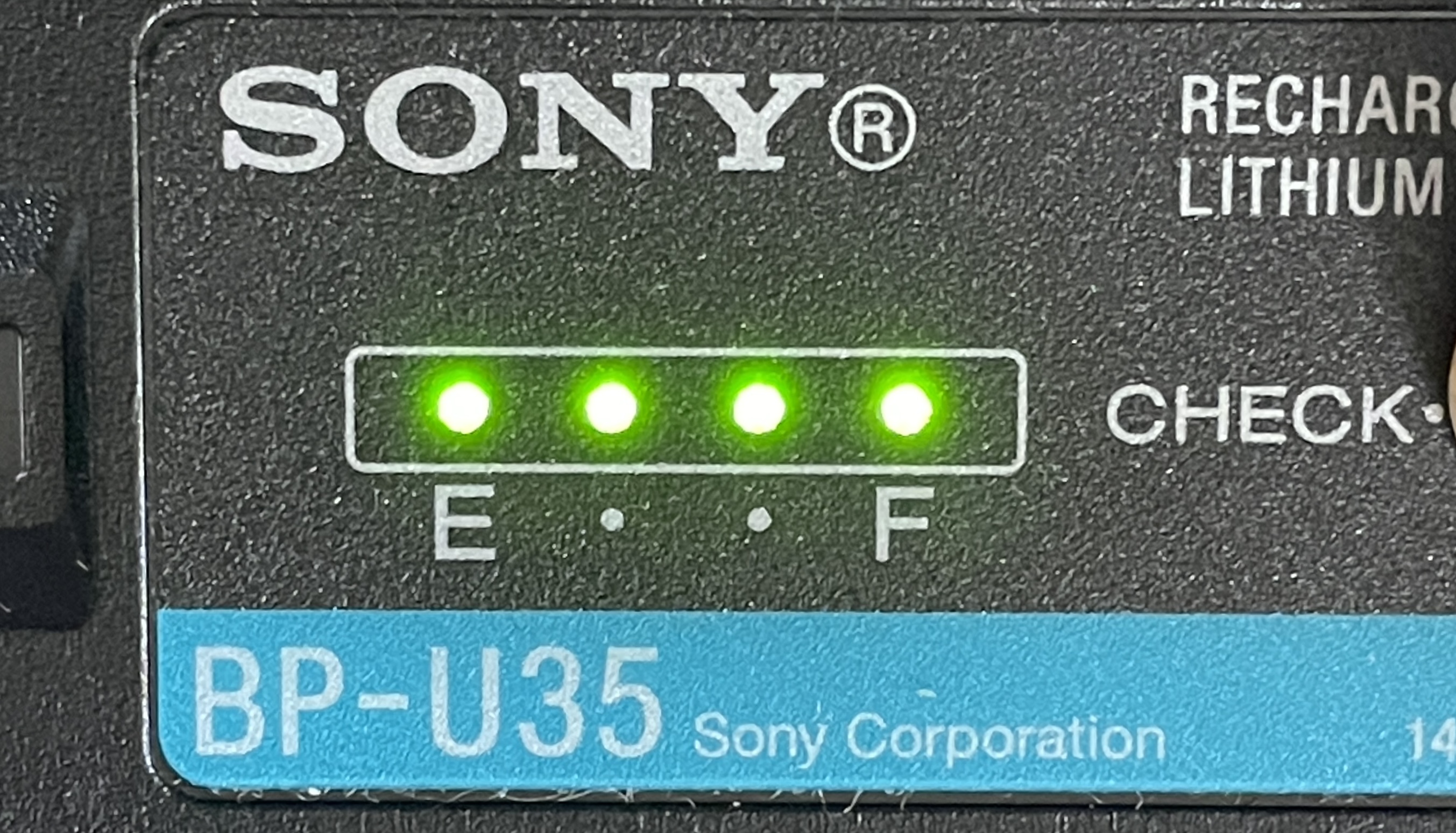

With the battery in the Charger, after a short time, the LCD had a flashing ‘E’. After some additional time on the Charger, the battery was put in the camera and the LCD Monitor displayed a warning and there was also an alarm with a red light.
a. Measured battery voltages between the left + and the - (L > R): 12.49, 13.00 13.00 (falling).
b. Left + to right +: 12.45V
c. Right + to left -: 0.0, 0.0, and 0.0V.
After even more time, the E light [see battery picture] became solid and the adjacent light became blinking; so, good news. The lights indicate the battery is getting charged. (Whew).
