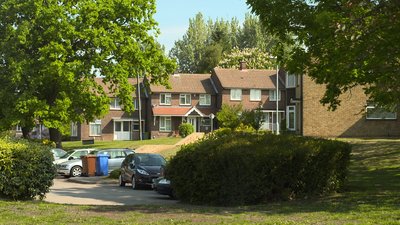

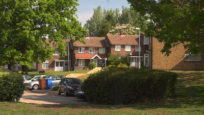

Here are some frame grabs from the shoot. Please note that the FS100 frame grabs are taken from the ProResHQ imports into FCP while the F3 grabs are from the re-wrapped .mov files.
FS100 and F3, Alister's Video-fs100-barge.bmp   FS100 and F3, Alister's Video-f3-barge.bmp
FS100 and F3, Alister's Video-fs100-bench.bmp   FS100 and F3, Alister's Video-f3-bench.bmp
FS100 and F3, Alister's Video-fs100-houses.bmp   FS100 and F3, Alister's Video-f3-houses.bmp

Thank you for the pics! I used after effects 32 bit with colirista 2 and Magic bullet looks on the Bench and houses.
Well...
The images from the F3 WERE exraordinary and Beautifully filmic!
The images from the FS100 do try to imitate the colour balance of the F3 but fall short. But even then its not the colour balance that is making the F3 footage so wonderful although that is helping but it can only be due to some other jiggerry pokery going on The F3 is the most filmic camera I have seen and my experience is limited however. I'd certainly love to make films with it.
I even called out to Samantha PLEASE I want the F3
The barge picture
F3 Beautiful
FS100 Highlights overexposed. Once white balanced the greens became less so The look was more HD and less filmic
The Bench picture
F3 Beautiful
FS100 Overexposed and White balance off but did favour skin tones so looked better When it was corrected it looked more videoish.
The Houses
F3 Beautiful but had to zoom in or the green trees was a little much but thats only because my screen is small would look wonderful on a 50" etc.
FS100 Of all the FS100 images this was the most pleasing but then I think this was less over exposed than the other two.
Most of the images were overexposed to some degree and most needed a little white balancing.

To try to create a level playing field both the FS100 and F3 were set up using REC-709 and white balance set to 5600k preset. This is not the optimum for either camera when it comes to dynamic range, but it should give the most natural looking images without grading. The houses shot is the most accurately exposed, it was shot after I reviewed the FS100 clips and realised I was over exposing. Given that both cameras have the same LCD panel and I used the histogram to compare exposures, I am still a little surprised at how big the exposure difference was. As I said in my review I put this down to the extra layers over the top of the FS100 LCD for touch screen operation. Certainly on location the LCD's looked very different with the FS100 lacking the crispness and contrast of the F3 LCD. If I had more time I would have re-shot the tests.
When I did try the Cinematone gammas on the FS100 I did not see any improvement in dynamic range, while I know from experience that with the F3 the use of cinegammas will increase the DR, but more importantly the highlights are handled in a more sympathetic manner that makes them grade better at the expense of mid-range compression, so the images do require grading.
I did not have sufficient time to investigate many aspects of the FS100 in as much depth as I would have liked. My conclusion is that both are extremely good, but that the F3 has an edge, probably down to improved internal processing. Given the price premium this is not really a surprise.
