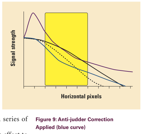

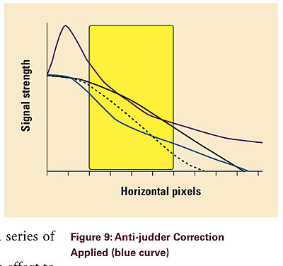

These Figures are from my new eBook sold by Broadcast Engineering.
You'll see that with a camera that only has a Sharpness control, you can only hope to reduce the boost without reducing resolution too much. (The dotted line.) Don't fully reduce Sharpness as it cuts resolution too much. (Red line.)
The other graph shows the anti-jutter curve available with Cine Alta cameras. It acts to suppress edge sharpness without reducing fine detail.
