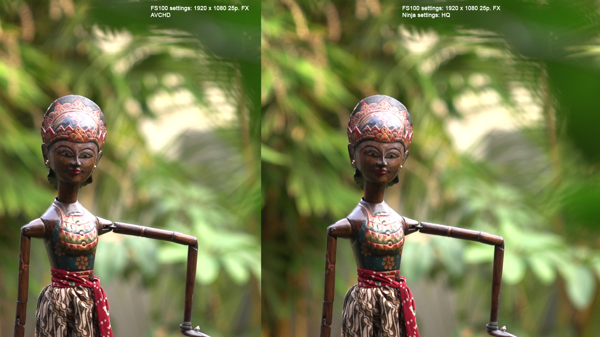

This is a test I did comparing the Ninja and AVCHD in progressive mode, and I'm chocked with the result. AVCHD does such a better job. Just look at the lines on top of the head of the doll, or on the top of the right arm. No color correction and the photo is already compressed by photoshop, but the difference is big
I will do a test in interlaced...

sorry, forgot the photo

I hope you're wrong. I just purchased a Atomos Ninja...
Indeed, I was wrong. Sorry for that. Change the firewire and the problem is gone. I tried to delete the post early today but I couldn't.

What do you mean by 'change the firewire'? The Ninja records via HDMI so I don't see any relevance to firewire.
To me, the issue looks like the Ninja did not convert the 60i signal to progressive. Last time I checked, the Ninja lacked some pull-down features. Maybe it still does or has not been updated?
