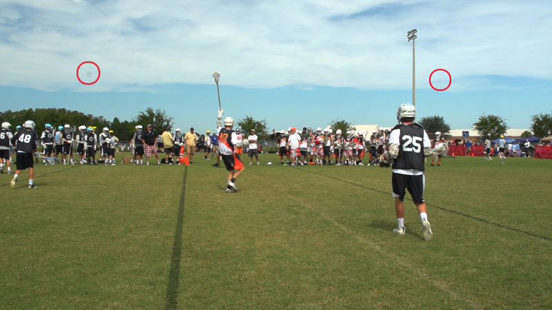

Space Hipster
Location: Jacksonville, FL
Posts: 1,596
Re: Small, fuzzy spots on the image.
Here is a still with the spots in the red circles.

Vortex Media
Location: Florida
Posts: 3,563
Glen, a dirty sensor will usually only manifest itself when you are shooting at a small f-stop. That's one of the reason I prefer to shoot everyting at f/4 and above. Looking at your still photo, I'd bet you were close to f/16. Just a guess.
I use lint-free swabs (look like Q-tips) and soft cotton wipes that I used to use to clean the heads on Betacam gear many years ago. They have worked great for me, but I couldn't tell you where to get them.
The first FS100 that Sony lent me before NAB arrived with a filthy sensor, so I had the advantage of experimenting with somebody else's camera. :-) I have cleaned my own FS100 several times since without any bad incidents, but you do have to be careful not to leave more crap that you clean off. BTW, I have never had to clean my F3 and it gets 10x more use than the FS100.
Disclaimer: Don't blame me if you ruin your camera -- but with that said, I have found that the sensor (or the glass in front of it) is not very fragile. I am not afraid to scrub it when necessary. But don't blame me if you ruin your camera!
