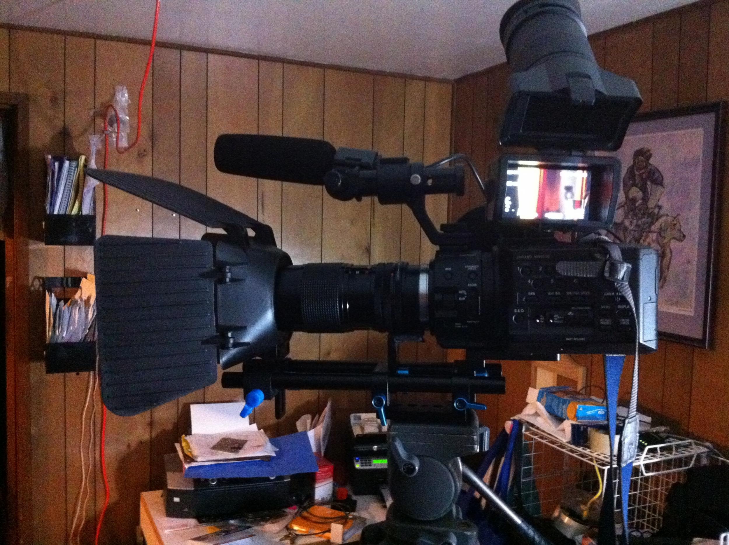

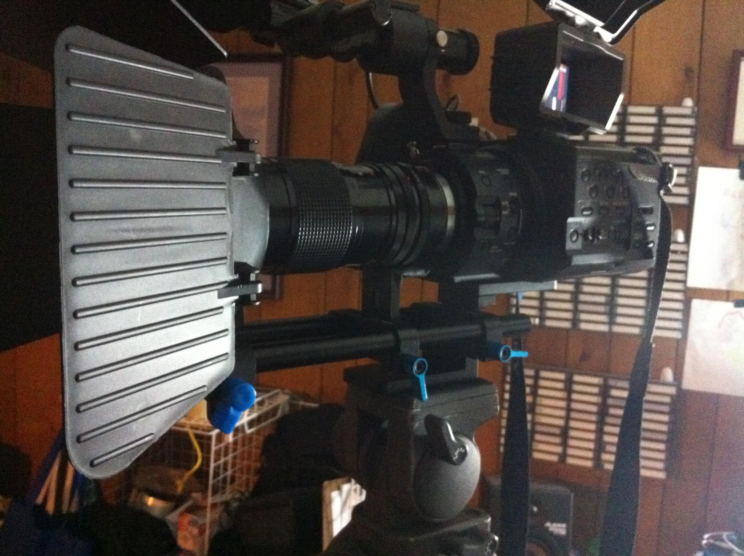

Ok, I'm back from vacation, and as promised, here is the picture of
my cheapo 'rig' for my FD lens set up. These FD lenses are heavy
and need lens support, so I had to get something. Pictured is the
28-90 F2.8 lens. I will be posting some video from this set up soon.
I have longer rails and a shoulder mount on order, but I can
at least shoot off the tripod now without being worried about the lens
mount having too much weight on it.
Canon FD lens set up/rig-img_0196.jpg   Canon FD lens set up/rig-img_0197.jpg

Yeah, I hear you on the 'reasonably priced' thing. I am not spending $700
or more on 'rigging' right now, it's just not going to happen. The
times I need 'rigging' are with the FD lenses, I don't have nice
expensive PL zooms or anything, so I just wanted something cheap,
and that would support my FD lenses. Also, I have a heliopan
variable ND, so I wasn't hugely concerned about a big expensive
mattebox at the current time either. So, I went on ebay and found
the cheapo stuff here:
DP500 DSLR rail 15mm rod support system rig for follow focus mattebox canon 5D 2 | eBay
(When I bought it, I got it for $80. Different vendors have it at
prices ranging from $80-$120. Search ebay for the DP 500 or something
and you will see. It is pretty well made, the only problem is the
rods are only 25cm long, which works, but they are a little short.
However, you can buy some 18 inch rods for $35 from Ikan which I am
doing).
Shoulder mount here:
CatClaw - Shoulder Pad Type A - Light! for 15mm Rod Rig system 5D2 7d HDSLR | eBay
Sunshade here:
New Matte Box for 15mm Rail Rod Support follow focus System D90 5D 60D 600D 550D | eBay
It's all stuff that works on standard 15mm rods. You can piece together
a decent system for under $200. Just look around ebay. Any questions,
let me know.
