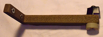

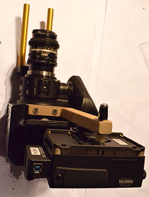

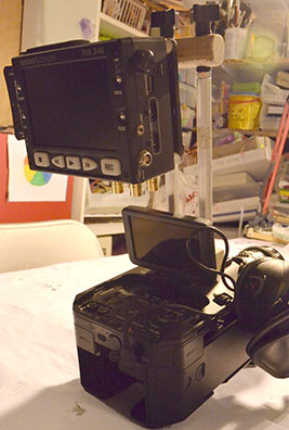

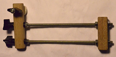

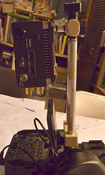

PIX 240 support rigs I built forthe FS100. #1 is a simple wood support. Both it and the mainly metal rig screw into the two 1/4-20 threaded holes on top of the camera. The second is a lightweight metal rig, shown before the main support legs were encased in aluminum tubes. Both rigs put the PIX unit high up, to clear the viewfinder screen. The wood support also moves it to the right side for clearance with less height.
The metal parts were later covered with gaffers tape, and the wood parts painted black. They hold the unit well, but with only one mounting hole, the PIX can wobble side to side a bit, harmlessly but a mild irritation.
Both are not too compicated to build. I can supply measurements if anyone wants.
The photos are apparently not going to show up in the order I uploaded them. The wood rig has a single vertical leg, and the metal one has 2 legs.
