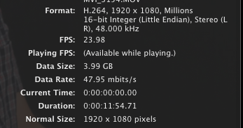

That has me wondering: the FS100 is set to 1080/24P at 24mbps. What does the 5D record in? What's the codec and bitrate in 24P?

My 5DM2 records 24p in H.264 at around 45mbps.

45mps? Really?

45mbps is true but its only part of the story. The camera uses a very simple version of H.264 which reduces the efficiency of the codec considerably. The very high bitrate in comparison with other cameras that use flavors of H.264 (such as AVCHD) can not be compared directly. The quality is fine for what it is but as an example of comparison it is not better than XDCamEX which is 35mb LongGOP MPEG2.

Yes, it can go over 50Mb/s. Its the only way to keep the moire/downres artifacts tolerable in first generation footage. Any re-rendering in post can bring the artifacts well above the threshold of perception.

I was equally surprised. That's what the Quicktime 7 file inspector is reporting on the original file copied off the CF card (attached).
