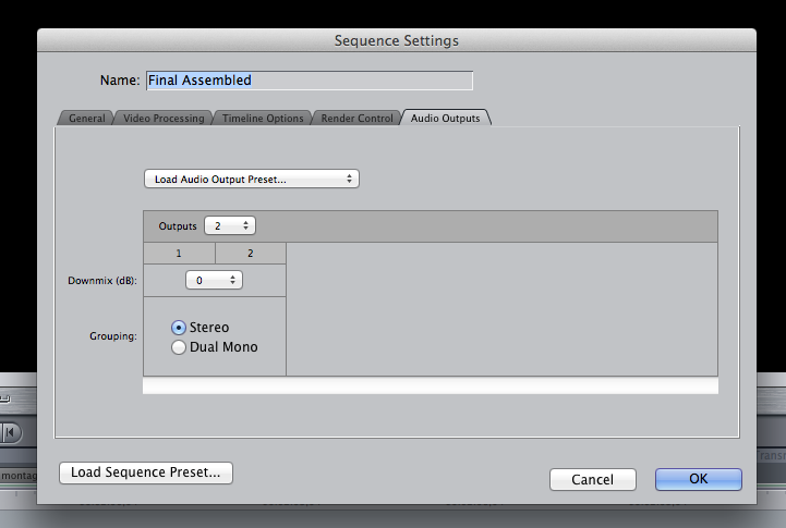

This may not be what you're looking for, but this might also work. Just select dual mono in your sequence settings like this:
