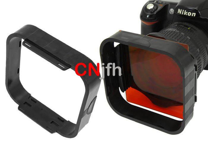

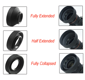

Random thought - has anyone tried the (shudder, dare I say the word) Cokin system? Maybe the Lee system?
IIRC, both have a 3 stage collapsable rubber hood that fits onto the filter stage. What it doesn't do is shade light from the filters in the mount - though this is a prime example of the delights of black-wrap.

I was alluding to that at #6 (top image) - rather than the three stage rubber lens shades (bottom image).

The rubber-ring hood seems the best option for lenses that predate plastic petal hoods, though.
