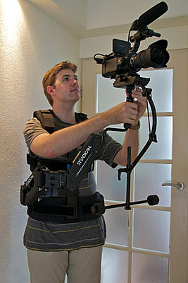

Today I received the Z-post to connect the Blackbird stabilizer to the Steadicam Merlin arm and vest system. The Z-post provides more clearance between the arm and the Blackbird.
If you like, here you'll find some more pictures and information:
DerranNL: Blackbird Stabilizer on the Steadicam Merlin Arm and Vest
