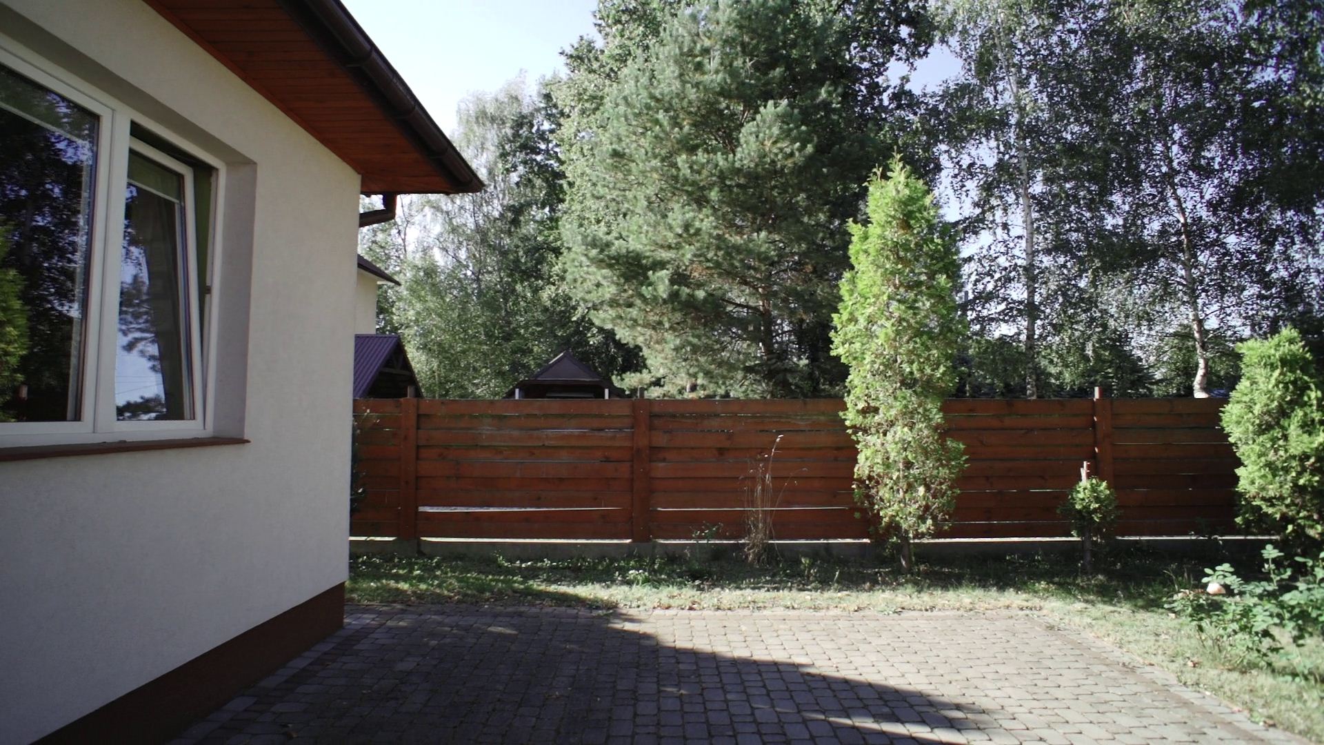

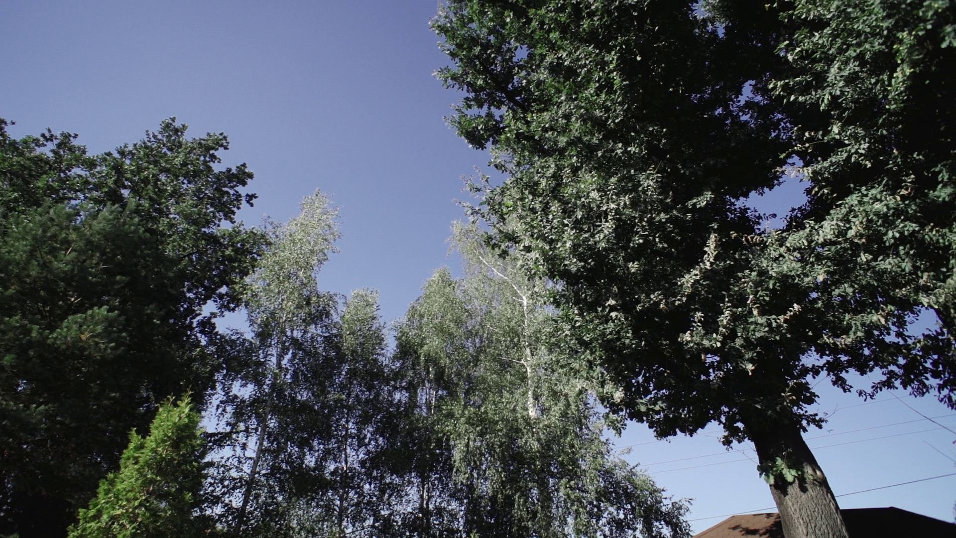

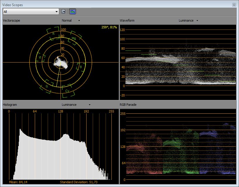

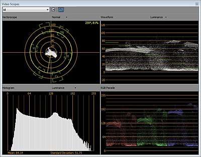

Well, I have found some flaw with this profile (even though I still consider it one of the best for the FS100):
I would like you to take a look at a couple of snapshots and tell me what's going on at the green foliage / blue sky contrasty borders, when they become grayish at the highlight roll-off. Without your profile, I suffered from a similar artifact we all know - shifting through yellow before clipping...
What do you think I could improve in the profile to avoid that? I tried under-exposing a bit which of course gets rid of these, but then the deep shadows become too dark (and the main point of your grading prescription - bringing shadows further down - become futile of course). BTW, the attached grabs are straight from the camera (no luma down-shift).
The Scopes apply to the grab on its left side at the bottom - again, straight from the camera...
Any suggestions? Perhaps the knee is misplaced for such contrasty scenes? TIA!

That's possibly an artefact of the weird way the color depth works by adjusting the luminance of saturated colours rather than the saturation. As the green trees are next to blue sky and both the green and blue channels luma levels are modified in the profile I suspect that close to the edge of the trees there is not enough green to get the full luma reduction that the G+2 setting is giving on other parts of the trees, so around the boundary the luma is slightly higher, pushing it into the modified knee, which is then reducing the saturation on anything brighter than 80%.
Try the profile with the all color depth settings at 0 and see if that helps. Color depth changes do some strange things close to the knee.

Thanks Alister, your analysis may be accurate. But then, it must be a synergy of both G+2/B+5 AND the knee setting, as plenty of other profiles I tried also have B and G channels' depth increased (luma reduced), and I yet none gives that artifact...
What I like about this PP is that - just like the EX1's Cinegamma2-based ones - it's very safe with highlight clipping protection, so especially for Glidecam work I'd like to continue using it.
Alister (and Frank) - what would you change first to try reduce this desaturation effect on green/blue edges, while keeping the above mentioned, general characteristics of this PP?

I'd probably raise the knee level a bit but that will allow the highlights to go above 100%.

I have to confess, I have no idea.
But what Alister said makes a lot of sense.
Try all color depth settings at 0 and see what happens.
